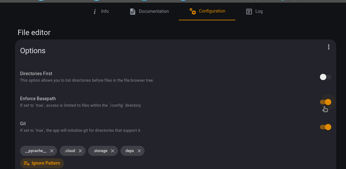

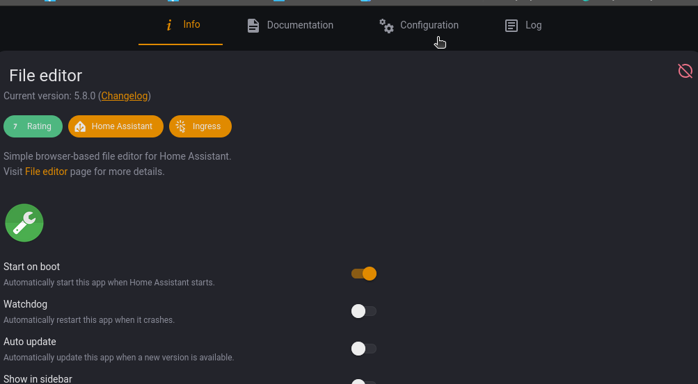

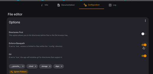

One example is using the editor. After finding “Add ons” in “Apps” with search, installation was easy and the toggle to show it in the dashboard was too. In the docs (Common tasks - Operating System - Home Assistant) it says to " open the Configuration tab and disable the Enforce basepath option." There is no such tab and I don’t see one in the menu, or anything related to an “*Enforce basepath” option. From what I read there are standard folders for HA, such as /config for configuration.yaml, but clicking on the upper left hand folder icon doesn’t use those names, making it difficult to follow docs that reference the standard folders such as /config.
Ok, I found some answers on the editor’s installation page under Apps, not within the editor where I was looking. The installation page has tabs for various things and a toggle widget for the “*Enforce basepath” option under the configuration tab. Another tab is for Documentation, although it’s rather small.

The tab in question is in the File Editor App’s settings.
