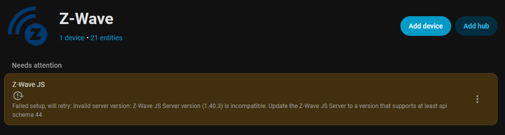

When attempting to use Zwave
Keep seem to running into this error.
" Failed setup, will retry: Invalid server version: Z-Wave JS Server version (1.40.3) is incompatible. Update the Z-Wave JS Server to a version that supports at least api schema 44"

If you want to switch to Z-Wave JS UI you need to uninstall the integration or re-configure the integration. Otherwise it keeps installing the core add-on.
You might need to try manually refreshing the add-on store to update the core-addon.
Hey yeah I did uninstall the integration & reconfigured it to the Z-Wave JSUI add-on. Yet whenever I re-install the integration the error immediately pops.
You have the box checked that re-installs Zwave JS again. Installation of Z-Wave JS UI Appears to be "broken"? - #5 by DRMiller453
Uncheck the box.
Yes that box is unchecked
It appears whatever you did was not successful, because the integration is still connecting to the core-addon. You can verify the Server URL in the integration settings. You can try looking at this guide, maybe you missed something.
The solution was that I was using an automatically detected Z-wave ?device rather than searching Z-wave in the store itself.
