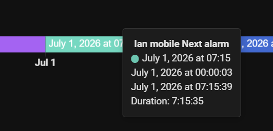

Re-enabled my next_alarm sensor yesterday when I read your thread, & I can confirm something funny is indeed going on, but can't reproduce your actual issues..
From what I can tell, the sensor is only updating with the next alarm when the next midnight comes around. Weirdly for me, it only happens with repeat alarms. I set an alarm yesterday at 19:40 for 19:45. I updated immediately, but was stuck on 19:45 till 00:03. Once midnight rolled around, the sensor picked up the correct alarm time at 07:15. Did the same thing just now with an alarm set for 2 minutes later & it also updated immediately & is still stuck there.
It's been a while since I disabled the next_alarm sensor, but I seem to recall it has always behaved that way. Not quite sure why, but there's 2 plausible options:
