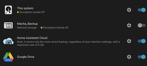

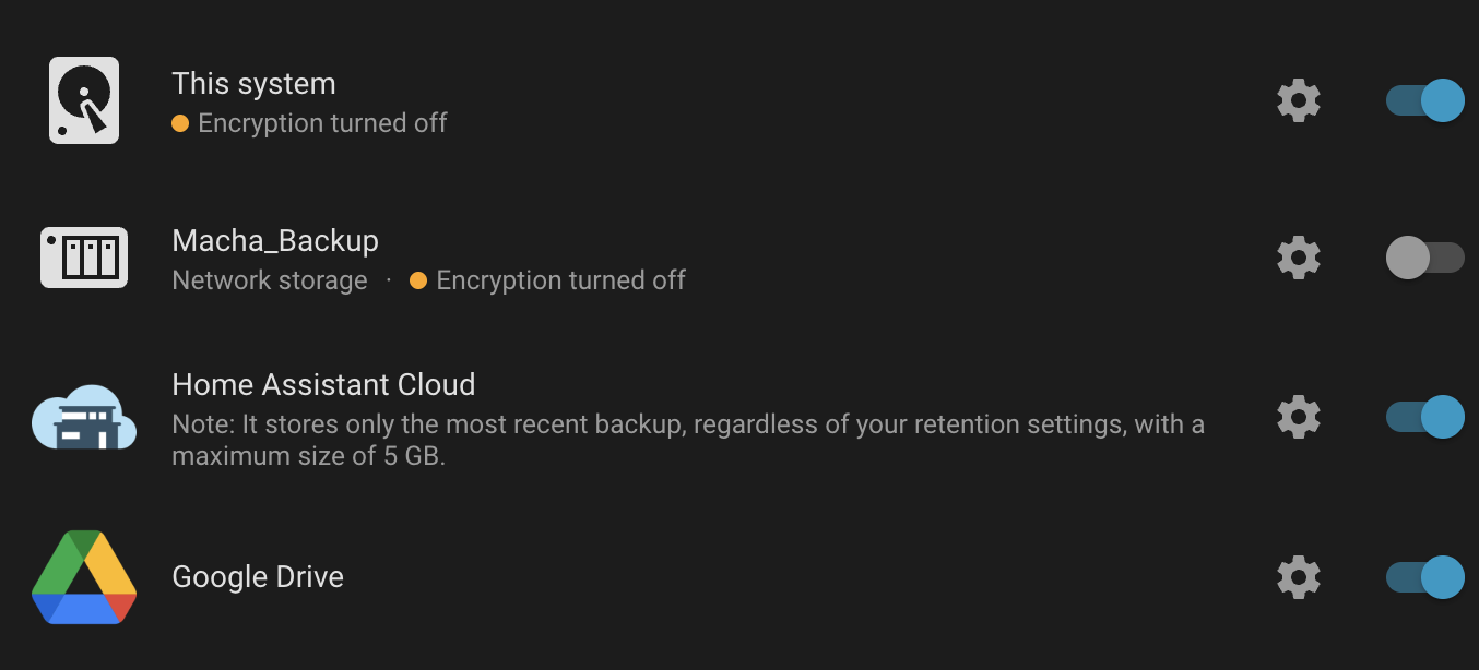

I’m having the same issue. I spent the better part of a 1/2 day trying to figure out what was happening trying all sorts of ways to work around it. I found that by turning off backup encryption for the nfs location now allows the backup to complete. I also create backups locally and was able to leave encryption on for that location.
Interesting. I already had encryption turned off for my nfs backup. It’s something odd in HAOS as I can copy a backup to my laptop, connect to the nfs drive and copy it to the nfs mount no problem from my laptop.
