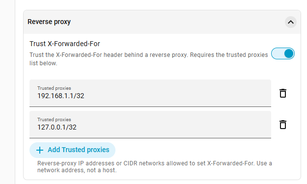

After the 2026.8 change in HA I had to add the following in under settings / network reverse proxy to get NGINX and Duckdns working correctly. The docs on NGINX have not been updated. HTML is NOT in Yaml anymore. You will notice the trusted proxy called out in the docs is not in mine. Playing around and asking I was told it is not needed with my confirguration. the 127.0.0.1 is my local loop back and the 192.168.1.1. is my router IP. It took me awhile, but once I did this I have been stable.
I am using HAOS so it may not be the same for you. I can access the network both internally and externally with no errors as I have for years prior to 2026.8. I never really studied networking and was not understanding what I was doing. I just copied the docs and or video information and hoped it worked. When it did I had no understanding of why? Router forwarding?, Duckdns? Nginx? Or Home Assistant misconfigured? I was not getting error messages in any log files, just connections dropping or not connecting at all.

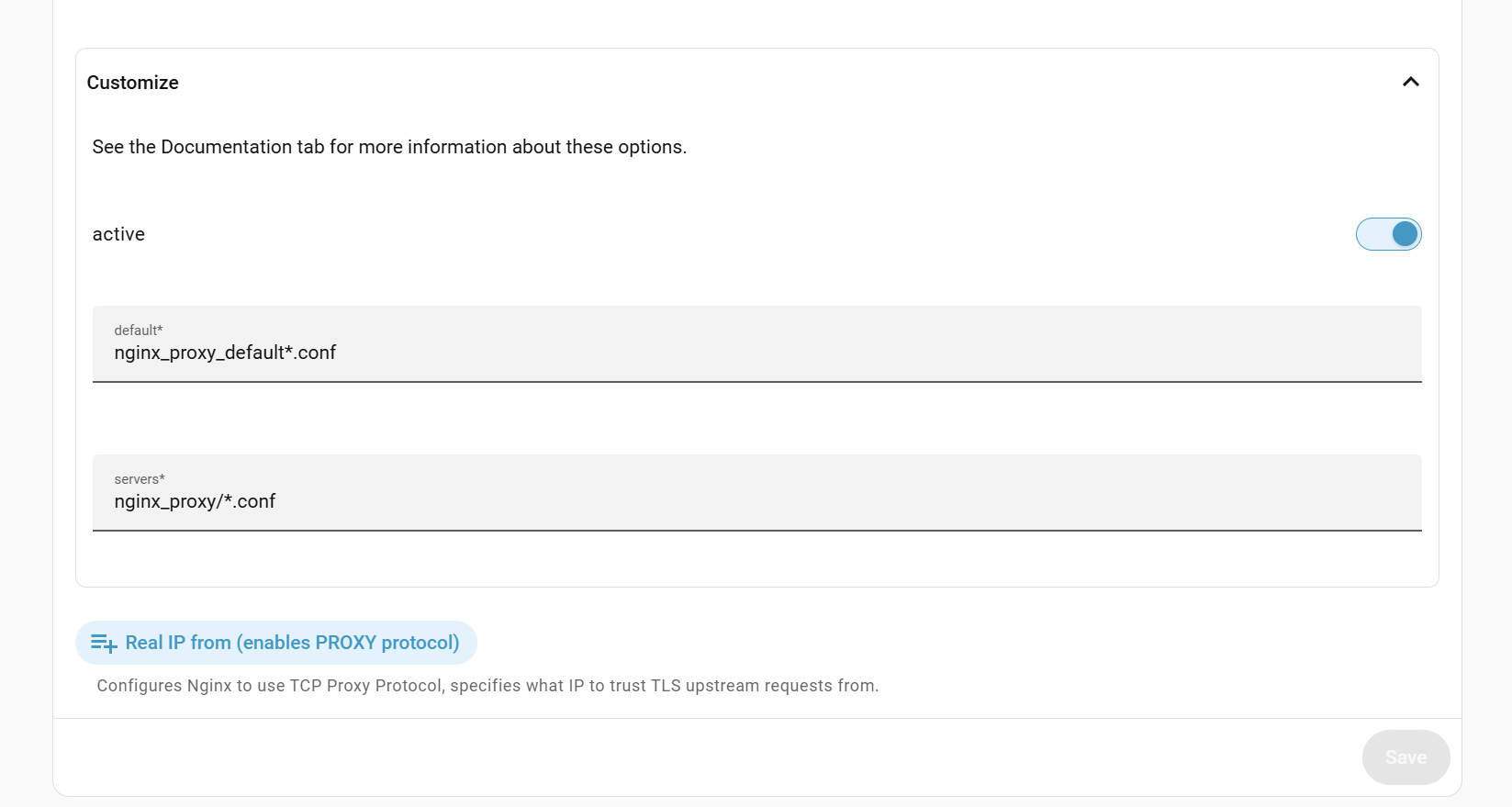

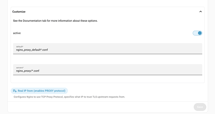

I have some questions of what you’re suggesting above:
  • under NGINX settings customize, there is nothing in the UI showing a server block so can I assume correctly you want me to check the config YAML settings?
    IN which case my YAML config file is…
domain: tarshisdevineha.duckdns.org
hsts: max-age=31536000; includeSubDomains
certfile: fullchain.pem
keyfile: privkey.pem
cloudflare: false
use_ssl_backend: false
client_max_body_size_megabytes: 1
customize:
  active: true
  default: nginx_proxy_default*.conf
  servers: nginx_proxy/*.conf
real_ip_from: []
And if I should add the path in your post to my YAML config file for NGINX, do I also need to copy/move the tesla public key into that path?
I also have a nginx_proxy_default_tesla.conf file in the /share/ folder (is this the one you’re adivising to edit?) which currently states:
location /.well-known/appspecific/com.tesla.3p.public-key.pem {
  root /share/tesla;
