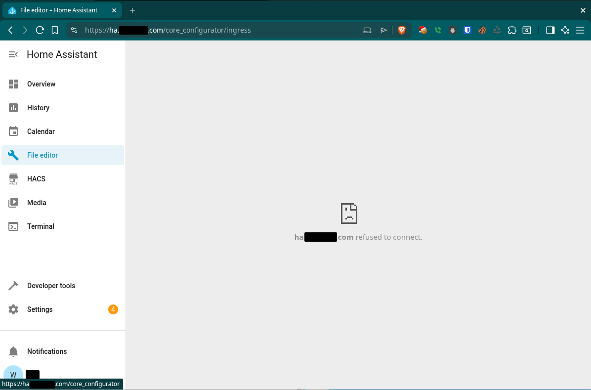

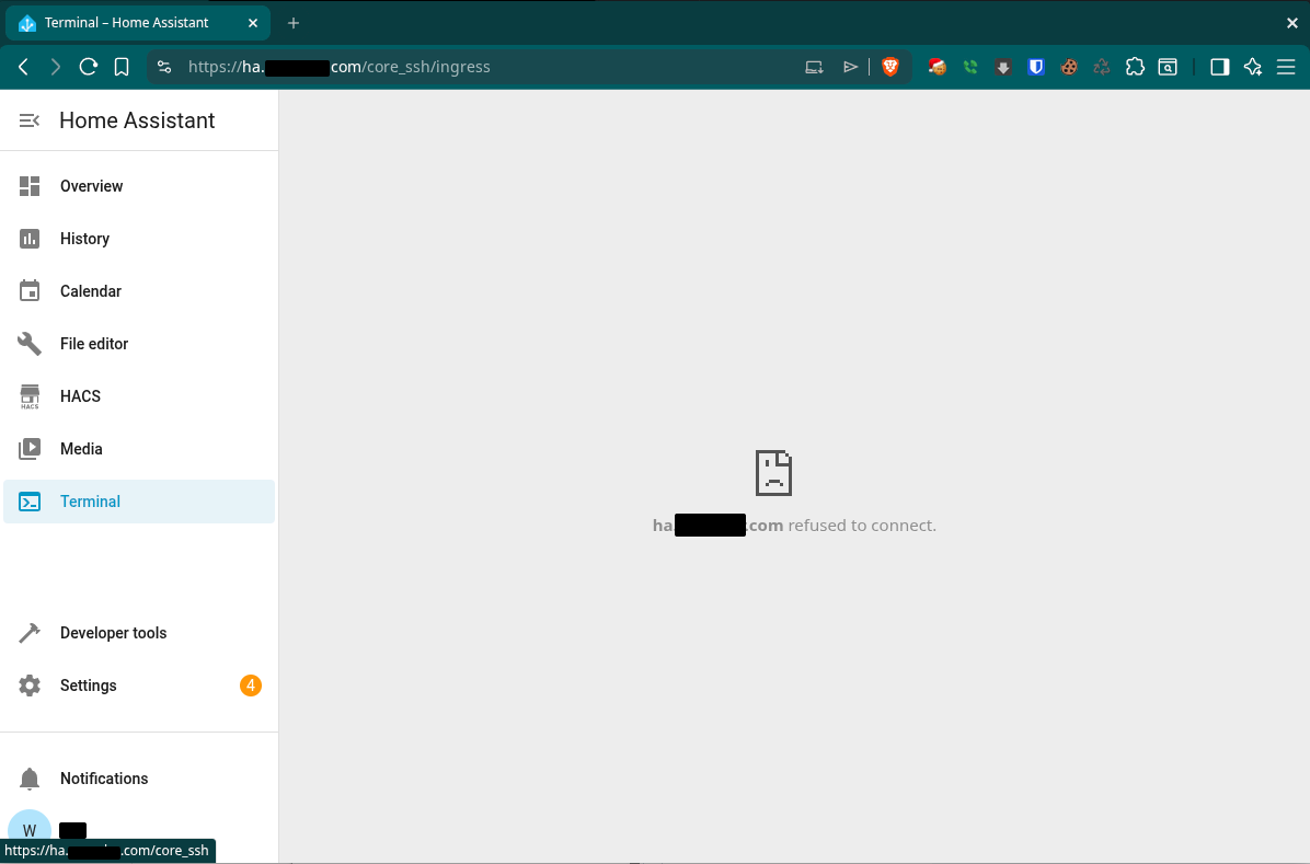

I have an nginx reverse proxy setup and most of Home Assistant works. The File Editor and Terminal & SSH addons do not. They work just fine when I access via http://10.10.1.98:8123, but not when I access through my hostname / reverse proxy. I get “ha.<my_domain>.com refused to connect”:
Here’s what I get when I go to Terminal
and here’s File Editor:

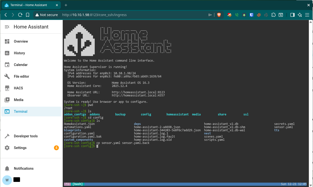

When accessing without the reverse proxy, these addons work fine. Example Terminal:

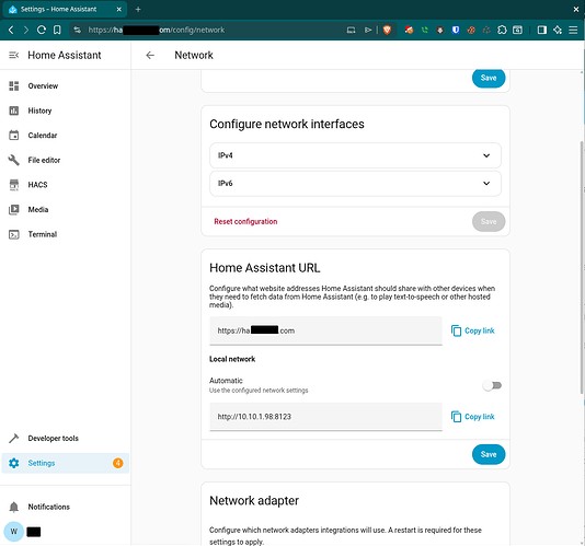

The output of the terminal hints to me that maybe Home Assistant thinks its URL is “homeassistant.local:8123” but I’m not sure how to change this. In Home Assistant > Settings > System > Network I have the URL set to my domain:

I figured it out! By happenstance I restarted my machine and the Brave browser used a ton of CPU for reasons I couldn’t fathom. So I rage quit it and started Firefox, and the message Firefox displayed was that Firefox wasn’t allowed to display the page in a frame … that I had to open it in a new window instead.
Well, that behavior is X-Frame-Options "DENY" header! I removed that from my config and BOOM, File manager and Terminal rendered correctly.
