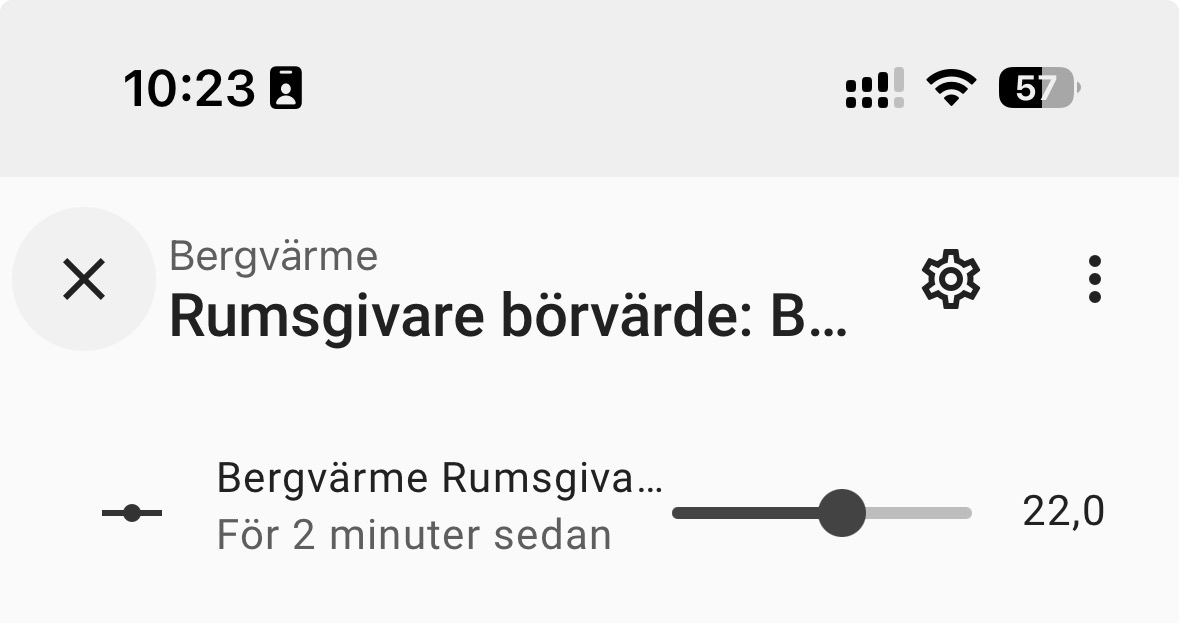

Anybody know if you can set this value from the MyUplink integration (temperature setpoint) from the local API? Know that it hasn’t worked with modbus on the S series. (I have an S1156)
I am struggling with this as well. It does not seem to work with local RestAPI (I can set the value but it does not change i reality).
What I read is to use External Adjustment instead, wich works. But it seams far to agressive, and maxes my supply temp evet at small changes…
Hey Tonny, how did you make External Adjustment work? I have tried MyUplink to set External Adjustment temperature for climate systems using room sensors, but I cannot have the climate system use it when calculating the supply temperature for the shunt group. The climate systems targets (menu 1.1.1) is being used, and the dynamic override path (External Adjustment) don't work. Appreciate any tips.
Thanks,
Bjørn
Hey, I struggled with this as well, in order to have external adjustment work, I needed to:
  • enable CSn External Adjustment register
  • Input on ECSn affects ECSn turned on when I want to override set temperature
  • Terminate pins on ECS 40/ECS 41 climate sone (just added a wire across pin 17 and 18 on AA5-X2)
In this way I have a base set temperature set on the heat pump (normal temperature) and then I override when needed.
