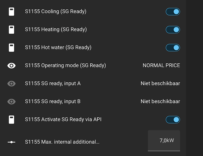

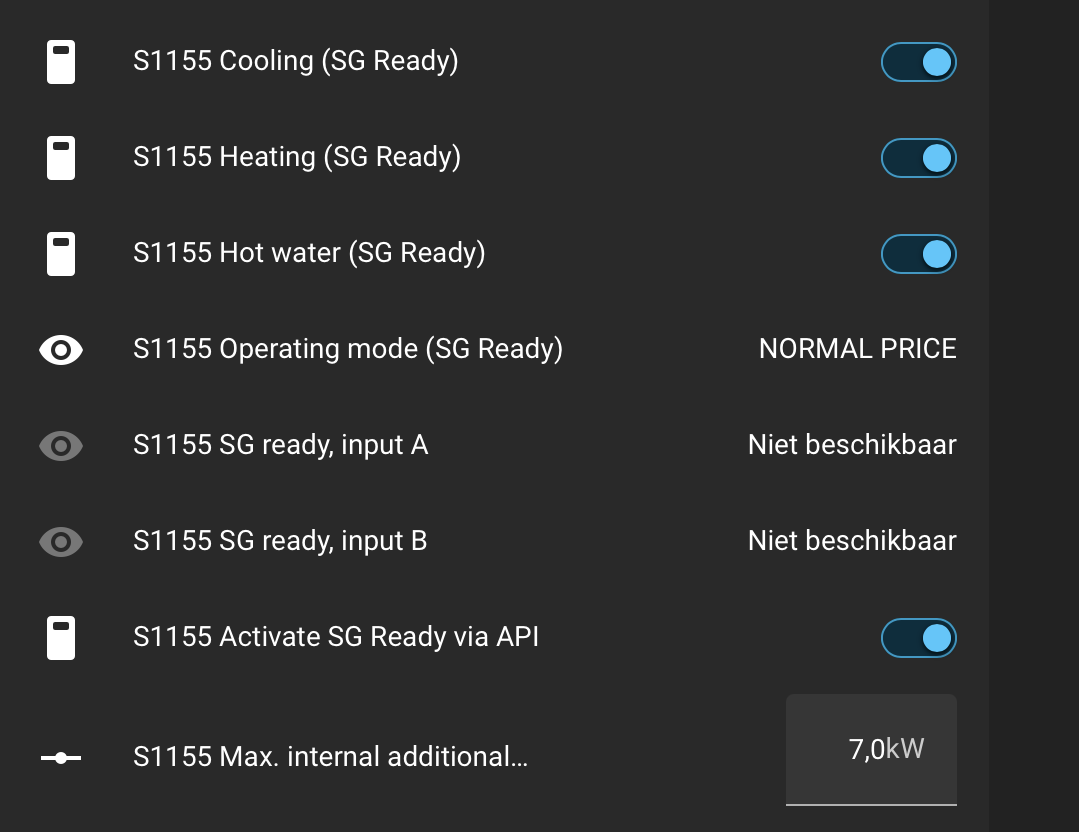

Do you have sg ready working? I activated the entities in ha and activated the api but sg ready input a and b are unavailable and operating mode I can’t switch:

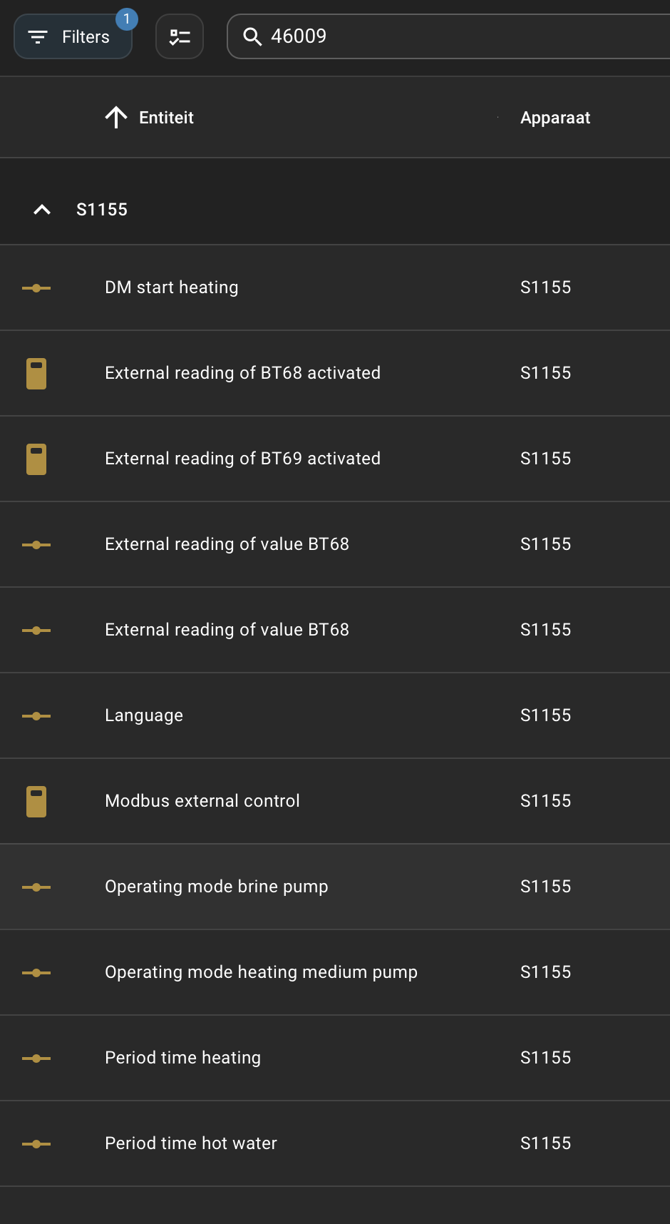

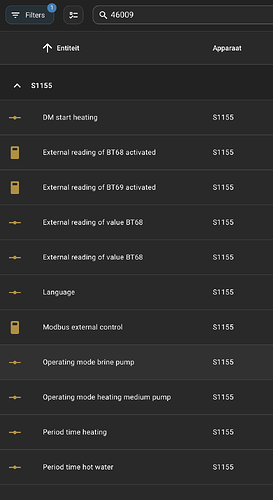

I am running ha 2026.8.3, if I search on the number I find these:

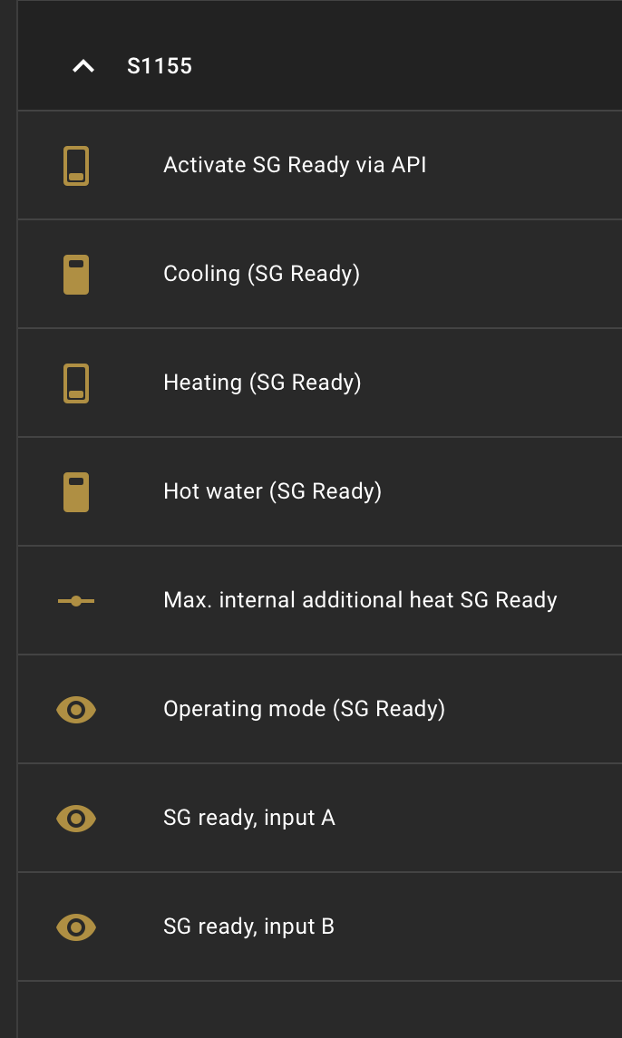

Only these:
Interesting, I guess yours doesn’t support this functionality then.
As far as I know it should but I will create a ticket, maybe the entity should be added for the s1155
