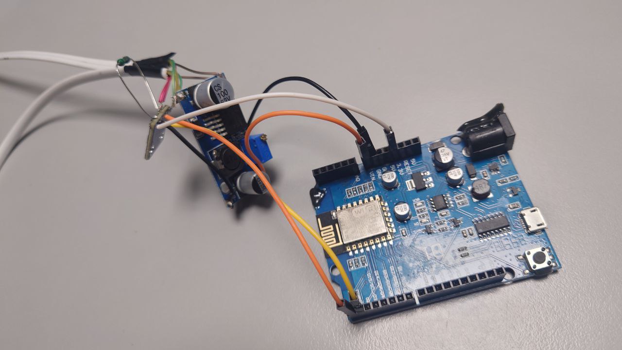

May be wires from wemos to CAN transeiver is too long?
5 or 7 cm only
  1. Try to soldering rx tx to wemos pins
  2. Try to replace rx tx wires
  3. Try change wemos to another esp8266 board
  4. Try connect dc-dc to 5V pin wemos. Not Vin.
I was blocked by forum for 16 hours, because too many replies …
But I discovered this:
  • Try to soldering rx tx to wemos pins - try as 1. - no change
  • Try change wemos to another esp8266 board - not try yet
  • Try connect dc-dc to 5V pin wemos. Not Vin. - try as 2. - no change
  • Try to replace rx tx wires - try as 3. - drive initialized, control (open/close) via esphome works, but after power off and power on nice gate - again no initialize, only OXI response .. no luck with any other power down and up …
I must find another ESP8266 board tommorow, test it and let you know.

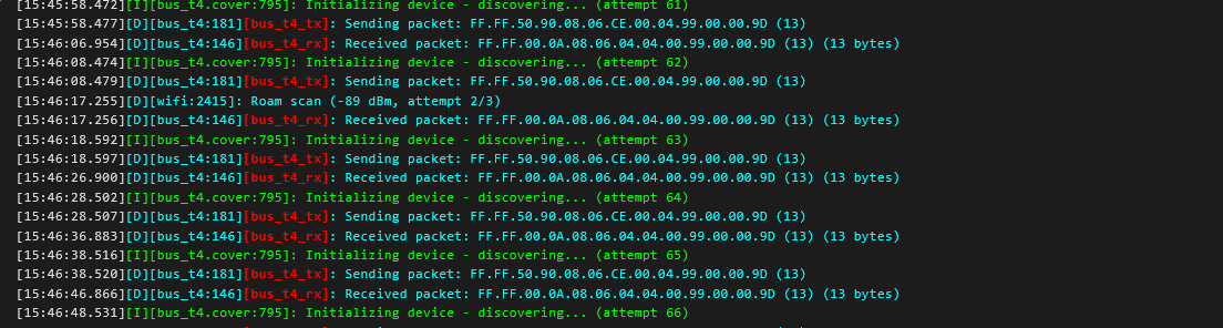

Log from sucefully initialized controler/motor, and after restart nicegate no work again …

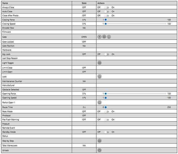

I found this interesting repo Nice BiDi-WiFi ESPHome Component. Has anyone tested it?
Hi!
I’ve been working for quite a long time on integrating my Nice gate (FILO400) with Home Assistant.
I already had a working setup before (you can find my earlier posts in the thread), but unfortunately the electronics damaged the main control board due to a bad level-shifter circuit. That setup was based on an ESP8266.
To avoid similar issues in the future, I’m now planning to move to the official BiDiWiFi module and modify it for this purpose. My only challenge is that the number of available solutions keeps growing, and I want to go with something that is as feature-rich and flexible as possible.
What you shared here looks very promising, since I was able to get it running on a simple ESP32 board with a small modification:
external_components:
  - source:
      type: git
      url: https://github.com/bpietroiu/esphome-nice-bidiwifi
      ref: main
    components: [ nice_bidiwifi ]
Using this, everything seems to work perfectly, although I haven’t yet tested it on the official BiDiWiFi module. However, if it works like this on a basic ESP32, it should also work on the BiDiWiFi hardware.
Once the rainy weather is over, I’ll do some real-world testing and report back with the results. In the meantime, I’ll attach a few screenshots.
Hello, I installed the Novamaxx version on a Nice Bidiwifi and I'm getting this result. What do you think the problem is?
nice mc824h
Thank you
Hi. I was a bit scared of frying my Nice gate trying to mess up with the T4 and I instead made this: github.com/Jordi-14/homeassistant_nice.
It's a Home Assistant integration that talks directly to the BiDi on TCP 443.
Still planning on improving it and maintaining it but I would love to have some people test it. It doesn't require any hardware.

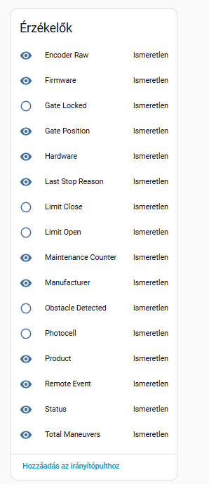

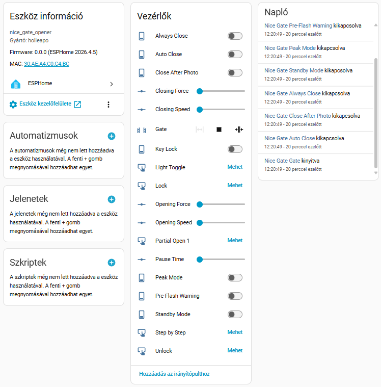

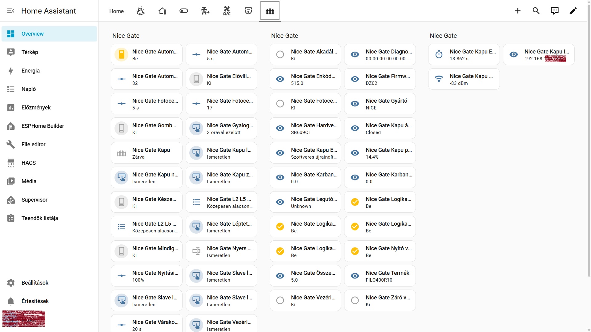

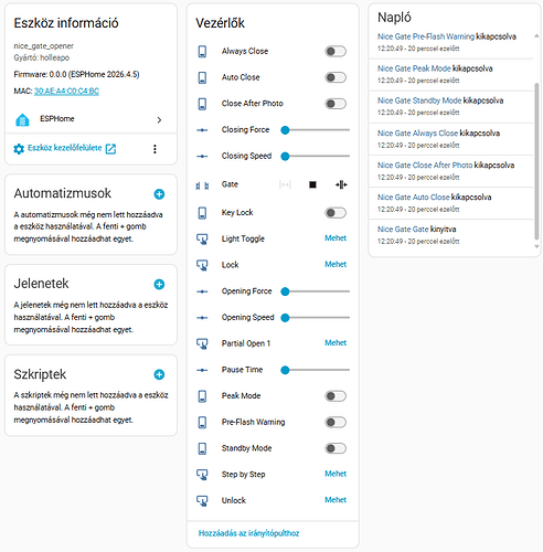

Hi everyone!
I’ve got some great news regarding the BiDiWiFi front:
Since my last post, I have successfully flashed the stock BiDiWiFi module with ESPHome. Right now, it is controlling a FILO400 gate opener, and it works flawlessly.
A quick heads-up: The ESP32 draws a significant amount of current during reboot. Because of this, my initial test failed right after flashing the firmware when it tried to restart. It only started working properly after I connected it to a higher-current power supply.
To give you some background: I am talking about the original, stock NICE device here. I decided to sacrifice it for this project because I couldn't custom-build something similar for the same price—or if I did, it would look pretty messy, and if I messed something up, I risked frying the NICE mainboard. One more thing: the soldering points shown in the picture are extremely small and delicate, so please be very careful!
In my YAML configuration, I translated the interface into Hungarian and added a few neat extras (uptime, Wi-Fi signal, and reboot reason).
As I mentioned, it works beautifully, and Home Assistant picked it up right away. Honestly, I'm facing an embarrassment of riches at the moment; it provides so many options that I still need to filter out the specific entities I actually need.
An observation regarding Wi-Fi: The outdoor Wi-Fi signal is quite weak in my setup because the thick brick walls of my house shield it. However, I can confirm that the system works reliably even at -80 dBm. If you are building a similar setup for yourself and have a similarly weak signal, it’s definitely worth considering an external antenna option.
I won't go too deep into the technical details for now, but I will mention that since I have a sliding gate, I am going to remove the unnecessary entities from my final YAML file.
With this ESPHome firmware, the device correctly identifies the manufacturer, the gate model, the mainboard's firmware version, and the hardware ID as well. The opening detection works great, showing exactly what percentage the gate is open. I particularly like the light switch entity, which controls a relay. In my case, it won't be switching a light; instead, I’ll use it in the winter to turn on a heating element to prevent the gate mechanism from freezing.
I'm only uploading a single screenshot for now, since the final dashboard layout will look different for everyone anyway.
I almost forgot: these are the parameters I used in my final YAML file:
