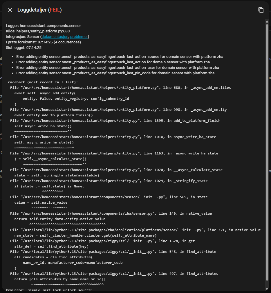

This is the same for me, and I see some error messages in the log at startup time:

Unfortunately it didn’t, ZHA is still picking up the zigpy.quirks.v2.CustomDeviceV2 quirk even though the file and configuration for the custom Nimly quirk is present.

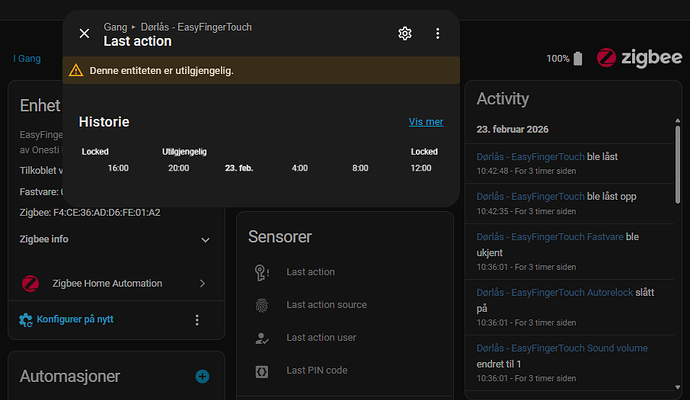

I can see the last action sensors but they are not updated when the door is unlocked :sweat:

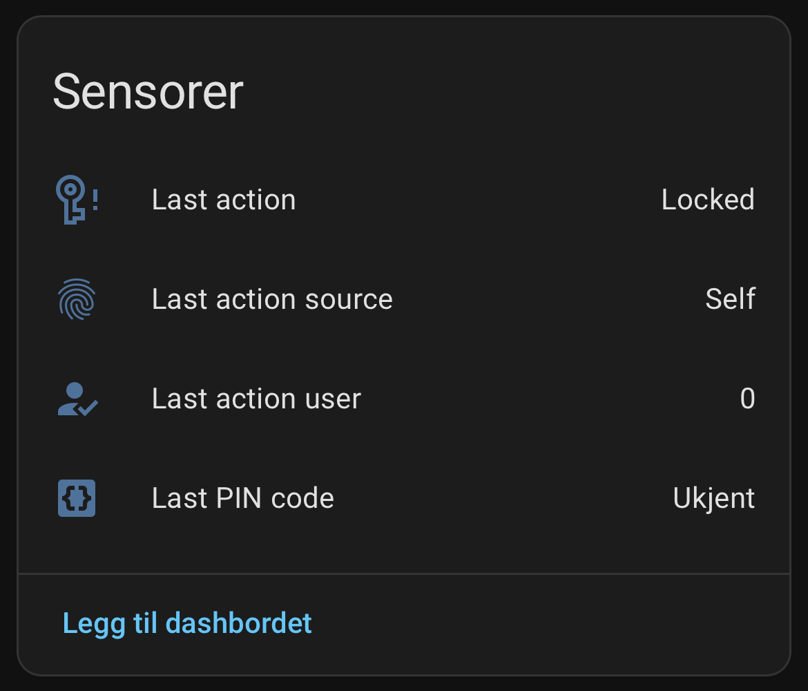

Hi @uvnikita, I have been fiddling around with this lock as it would not produce the “last action” data.
As shown in the screenshots, if I remove the custom quirk, the sensors become unavailable. If I add the custom quirk however, the sensors look OK, and for a few days before an update it also worked :grimacing:
No custom quirk = Sensors are unavailable
Custom quirk added = Sensors look ok
