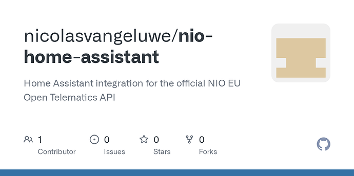

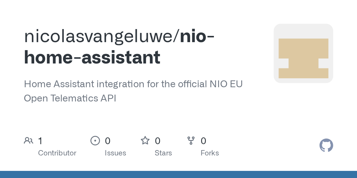

I’m building an unofficial Home Assistant integration for NIO vehicles using NIO’s official European Open Telematics API.
Repository and installation instructions:
The current development release can be installed through HACS as a custom repository.

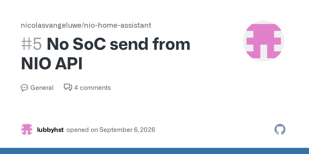

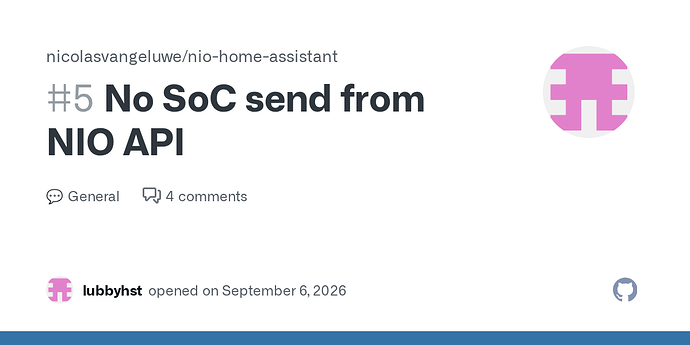

  • The API currently returns battery SoC as 0.
  • Remaining range and charging information are missing or null.

I removed this comment and added it on the github thread instead:
