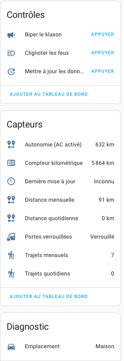

The data provided by the integration for a Qashqai ePower

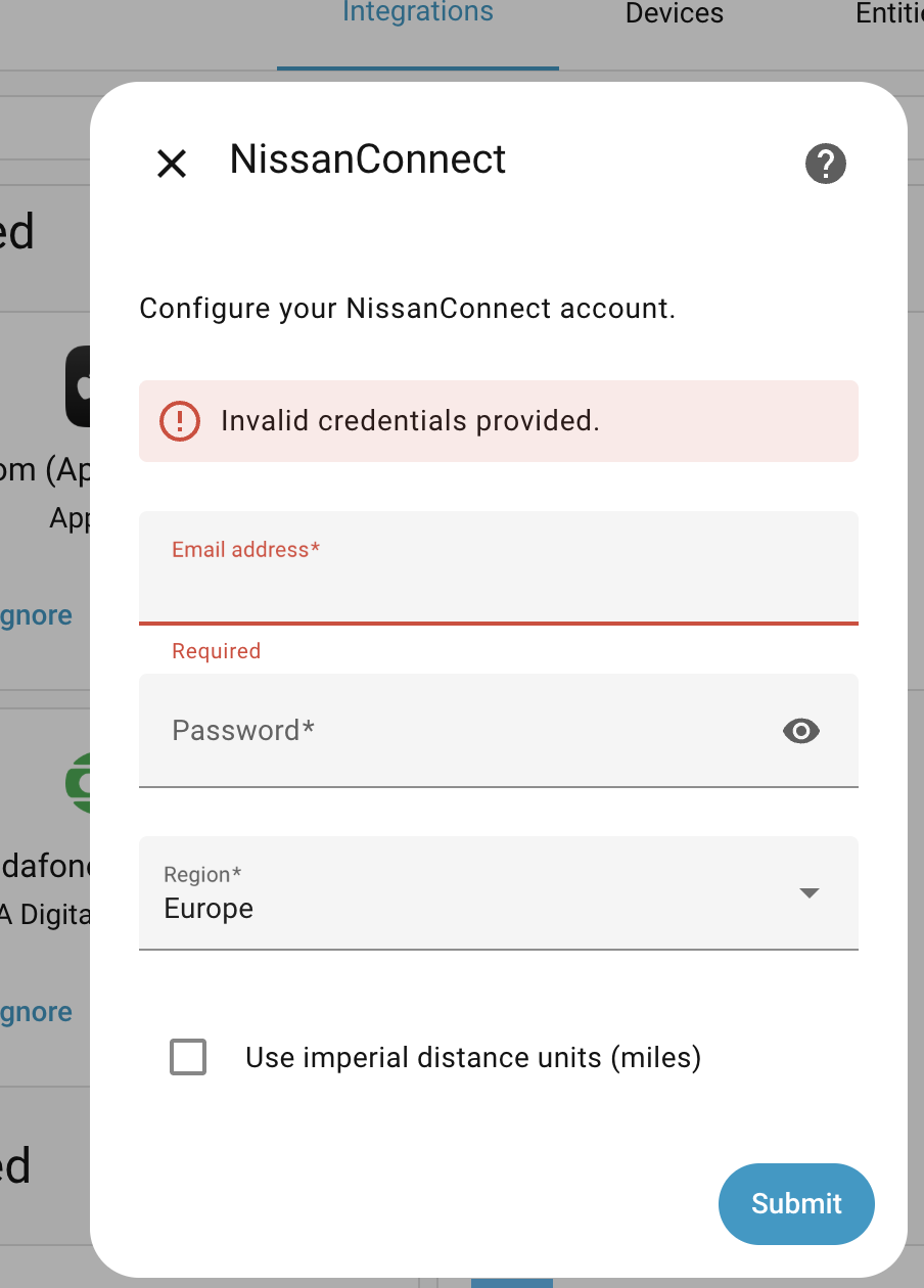

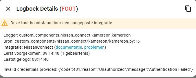

I can’t seem to get it to accept my Nissan Connect credentials. I’ve tried changing my password, no problem with the Nissan Connect app on Iphone.
I’m in UK, the region dropdown only has Europe as an option.

The Europe region is correct for the UK. Do you have any errors in the logs?

I’ve just taken delivery of a Ayria and I’ve added this integration which shows everything expect range, it just says unknown.
Has anyone come across this?

I’m having the same issue. Did you find a solution ? I’m using a BE Account that is working fine on NissanConnect.
