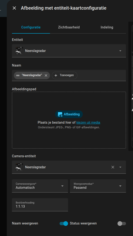

I’m still a HA novice and can’t get the radar chart to show permanently on the dashboard. In my dashboard I see a tile with the name, image and status Inactive. Only when I click on it, the radar shows. Could you tell me how to show it permanently on the dashboard? Thanks in advance.
Hmm… not sure what’s happening. The radar is a camera entity meant for security camera’s. Abusing it here for an animated gif of a radar.
To show it, you need to add a “Picture with entity” card on your dashboard. Add the camera.neerslag_radar entity in both places, and remove the image. You can play around with the other settings yourself. See the screenshot:
This is my raw yaml config for the dashboard card:
-  type: picture-entity
   show_state: false
   show_name: true
   camera_view: auto
   fit_mode: contain
   entity: camera.neerslag_radar
   camera_image: camera.neerslag_radar

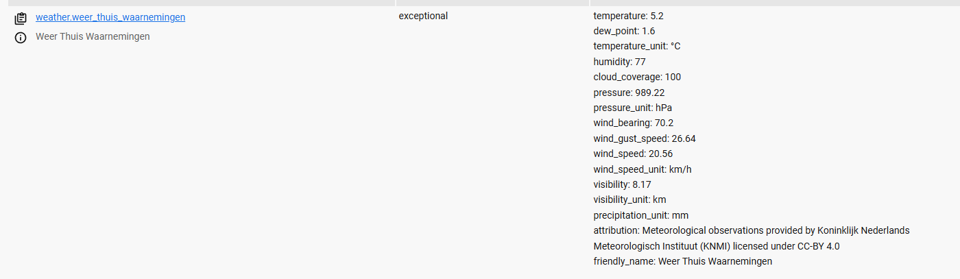

What does “exceptional” mean as “waarneming”?
It’s not exceptionally good or bad outside or so…
Good question! I think I made a mistake there. The weather condition (“exceptional”) in question is defined here in the code.
The weather code come from this table in the KNMI Handboek Waarnemingen. When looking at Table 6 there, code 4 and 5 are defined as “Heiigheid of rook, of stof zwevend in de lucht”.
I think I’ll list them under Fog. But then (as I do with the other Fog codes) look at the actual visibility range before declaring it as Fog. Only when visibility drops below 1000 meters it’s fog, above it’s mist (the English word, not the Dutch).

Ok, understood but still a weird condition given the actual conditions outside yesterday :smile:

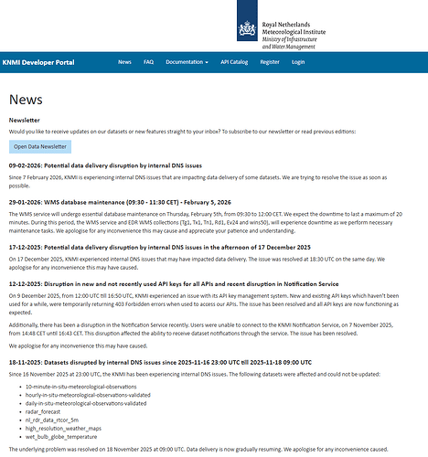

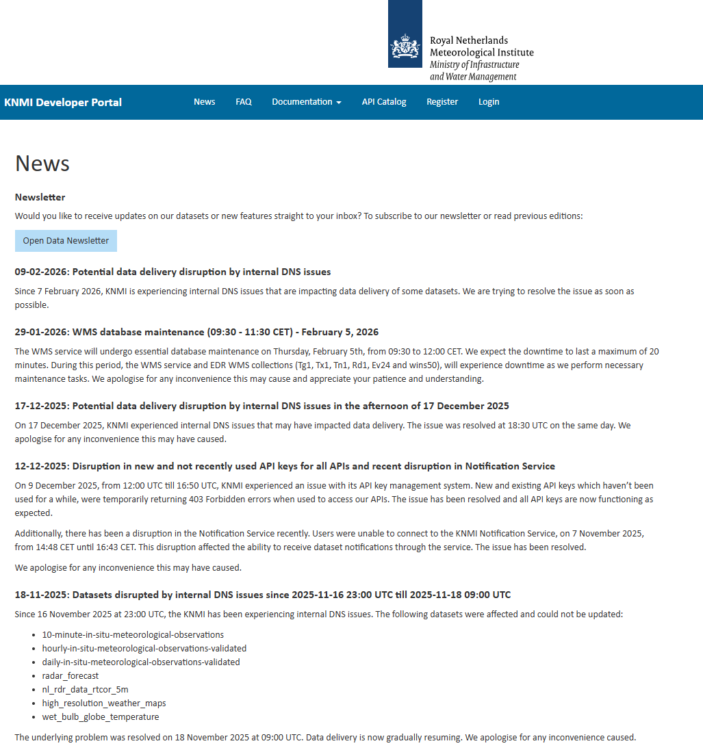

@PaulVanSchayck Not sure if this is related to one of my changes, or an API outage? I actually don’t think that my changes (that I’m running locally) caused this, but you might be able to verify :slight_smile:

edit: yeah, running vanilla 0.5.1 also gives me this error. Something changed serverside?
edit 2:
AH - it’s always DNS :slight_smile:
