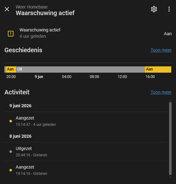

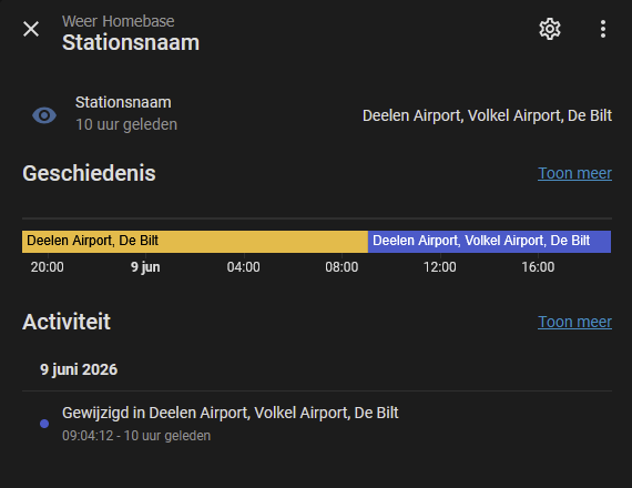

I seem to recall that I had set Deelen weather station as the fixed station, but I now see the information below. How can I edit the used stations and/or is there a logic in the automatic selected stations based on weather?
In addition, I was wondering whether the weather warning code sensor displays the warning color per province (i.e. based on the selected weather station), whether the warning code is applied nationally for the entire country, or whether it is determined using a combination of data from multiple weather stations when issuing weather warning codes.

Hmm.. if you've set a fixed station, it should only use data from that station. In automatic selection mode, it takes for each sensor the closest data it can find. Not all stations report all sensors. A sensor or a whole station can also be under maintenance. So that's why you will often see a combination of stations. I know that Deelen Airport is undergoing maintenance these days. So that would explain the switch you see. It's not based on weather.
The screenshot looks like it's using automatic mode. You can not change a location from manual to automatic after adding it initially. I haven't implemented the reconfiguration flow for that. You can open a GitHub issue for it, if you like. If you're sure you've selected manual mode, this could also be a bug.
You can always add a new location, and configure that. Maybe good to experiment with that, and see if you can understand what's happening.
The weather warnings are determined by the Region you've selected when adding the Location. They are not determined by either the location or the selected weather station. So you can have a location with Maastricht Airport as station and warnings from Groningen.

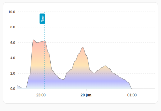

Functionality wise, I've added a precipitation nowcast graph. Showing when to expect rain, and how much. For your location.

There are two good ways to render a graph from this.
  1. Using Weather Forecast Extended, which makes use of the get_minute_forecast service. Refer to the configuration of that card, how to setup the nowcast entities.
  2. Making use of ApexCharts Card and render the data from the sensor. This is an example configuration:
type: custom:apexcharts-card
experimental:
  color_threshold: true
graph_span: 3h
span:
  start: hour
  offset: "-30m"
yaxis:
  - max: ~10
now:
  show: true
  label: Now
series:
  - entity: binary_sensor.weer_thuis_precipitation_forecasted
    unit: mm/h
    type: area
    opacity: 0.3
    stroke_width: 1
    color: gray
    color_threshold:
      - value: 0
        color: lightblue
      - value: 1
        color: blue
      - value: 3
        color: orange
      - value: 7
        color: red
    data_generator: |
      const data = entity.attributes.forecast || [];
      return data.map(p => [
        new Date(p.datetime).getTime(),
        p.precipitation ?? 0
Looking forward to seeing even better graphs being designed, and hearing what kind of automations you've made using this data.
