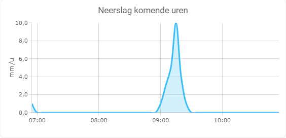

For those who are already using Plotly for graphs (instead of Apex), you can use this code to create the nowcast graph with Plotly:

Thanks a lot Hmmbob! :clap:
Took me a while to get all spaces right I guess your output needs to be added to the complete dashboard view and not the single card.
For those who want to paste just the card this is my copy and don't forget to rename the binary-sensor to the one you are using in line 5

@Hmmbob
My X-axis only shows the hours up to current time and no future prediction. In your picture you got almost 4 hours while for me it is just 1 hour. Scrolling to the right makes the rest appear.
If I add 'hours_to_show: 4' it just adds time on the left without prediction off course.
If I add 'period: auto' no difference.
Any idea what is happening?
Oops, still had a whitespace in the xaxis part, corrected that one and now it's better, phffw.

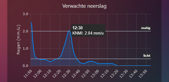

Here's my version of @Hmmbob's graph. :raising_hands:
Added some horizontal markings and made it look more like @aex351's ha-neerslag-card.
I also noticed the graph had its 'now' in the middle of a 4h width, so I moved the range from (now - 10 min) till the last data point.
Some other minor adjusments

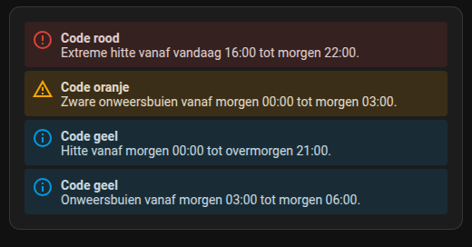

I've also just released version 0.12.0. This includes an update by @Hmmbob to make all weather alerts available as attribute to the alert sensor. Last week there were many weather alerts active at the same time, and the integration wasn't handling that very well. With the new alerts attribute on the alert sensor you can now print them. For example using the markdown chart:
type: markdown
content: |
  {% set alerts = state_attr('sensor.weer_home_alerts', 'alerts') or [] %}
  {% set titles = {'red': 'Code rood', 'orange': 'Code oranje', 'yellow': 'Code geel'} %}
  {% set levels = {'red': 'error', 'orange': 'warning', 'yellow': 'info'} %}
  {% if alerts %}
  {% for alert in alerts %}
  {% set code = alert.code | lower %}
  {% set title = titles.get(code, 'Weerwaarschuwing') %}
  {% set level = levels.get(code) %}
  {% set item = alert.description | trim %}
  {% set prefix = title | lower ~ ' voor ' %}
  {% set prefix_length = prefix | length %}
  {% set detail = item[prefix_length:] | trim if (item | lower).startswith(prefix) else item %}
  <ha-alert alert-type="{{ level }}" title="{{ title }}">
    {{ detail[:1] | upper }}{{ detail[1:] }}{{ '.' if not detail.endswith('.') else '' }}
  </ha-alert>
  {% endfor %}
  {% else %}
  <ha-alert alert-type="success" title="Waarschuwingen">
    Geen actieve waarschuwingen.
  </ha-alert>
  {% endif %}

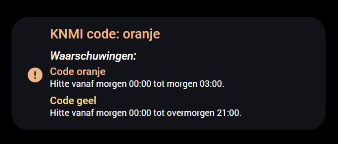

This incorporated to my custom:button-card and with fictional data it looks like attached now. It's barely visible here but it's a rounded card on a black background (it's inside a Bubble pop-up). I display 'none' as 'green' but the alert_active binary sensor could also be used to hide the card.
Card code if it's helpful to anyone:

          function kleurNaam(code) {
            return kleurMap[code] || 'grey';
          var html = '<div style="color:' + kleurNaam(c) + '; font-weight:500; text-align:left;">KNMI code: ' + (naamMap[c] || c) + '</div>';
          if (alerts.length > 0) {
            html += '<div style="height:10px;"></div>' +
                    '<div style="color:var(--contrast20); font-style: italic; font-weight:500; text-align:left; font-size:15px;">Waarschuwing' + (alerts.length > 1 ? 'en' : '') + ':</div>';
          alerts.forEach(function (alert) {
            var code = (alert.code || '').toLowerCase();
            var titel = titelMap[code] || 'Weerwaarschuwing';
            var item = (alert.description || '').trim();
            var prefix = titel.toLowerCase() + ' voor ';
            var detail = item.toLowerCase().startsWith(prefix) ? item.substring(prefix.length).trim() : item;
            if (detail.length > 0) {
              detail = detail.charAt(0).toUpperCase() + detail.slice(1);
              if (!detail.endsWith('.')) {
                detail += '.';
            html += '<div style="height:3px;"></div>' + '<div style="color:' + kleurNaam(code) + '; font-weight:500; text-align:left; font-size:14px;">' + titel + '</div>' +
                    '<div style="color:var(--contrast20); font-weight:400; text-align:left; margin-bottom:4px; font-size:12px;">' + detail + '</div>';
          return html;
      icon: mdi:alert-circle
      tap_action:
        action: more-info
      styles:
        card:
          - border-radius: 24px
          - padding: 12px 12px
        grid:
          - grid-template-areas: "\"i n\""
          - grid-template-columns: 40px 1fr
          - align-items: start
        icon:
          - color: |
                var c = states['sensor.weer_thuis_waarschuwingscode']?.state || 'none';
                var kleurMap = {none: 'var(--green)', yellow: 'var(--yellow)', orange: 'var(--orange)', red: 'var(--red)'};
                return kleurMap[c] || 'grey';
          - width: 24px
          - align-self: start
          - margin-top: 2px
        name:
          - justify-self: start
          - font-size: 18px
          - text-align: left
          - white-space: normal
          - overflow-wrap: break-word
          - min-width: 0
          - width: 100%
THX,

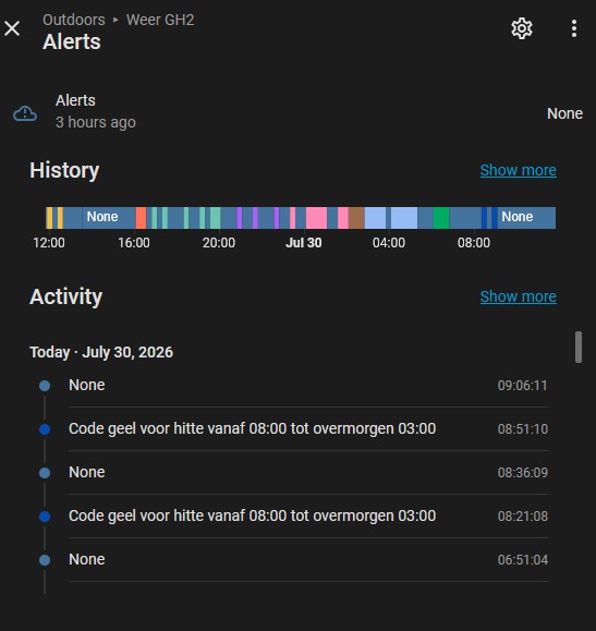

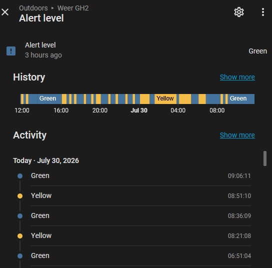

How is the Alert location determined?
Previously with the heatwave I did have the alerts (maybe whole country alerts) but now not.
I live in Gelderland (Maurik) and have stations Herwijnen and The Bilt , being in Gelderland and Utrecht. The KNMI app does show NO alerts for Utrecht and alerts for Gelderland; Code geel
Komende dagen warm tot zeer warm weer ?
Anybody else having no alerts when there should be one..
I’m running Version 0.12.0
I think it based the alerts on the station used for the data as my sensors show this:

It’s determined from the region setting when you configure a location entry from the integration page. The region is not automatically calculated from your location, so you need to manually set this. The default is Drenthe.
Your screenshots are showing a bug. This [bug has been reported] by others as well (Alerts switches intermittently to none during upcoming code · Issue #107 · PaulVanSchayck/ha-nl-weather · GitHub) and causes the alert to switch on/off for a few minutes. The problem is within the KNMI app API, but I need to see if I can work around it.
