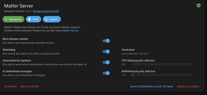

My Matter server is no longer available. And you can no longer install it either. And Matter (Beta) no longer works. I have no idea whether this is somehow connected.
Can anyone help me? I must have broken something.

I have restarted HA. Unfortunately without success. I can see other add-ons. The Matter server is also running.

So the addon is there and running?
Then what is not working, because that is what your first description said was at fault.
