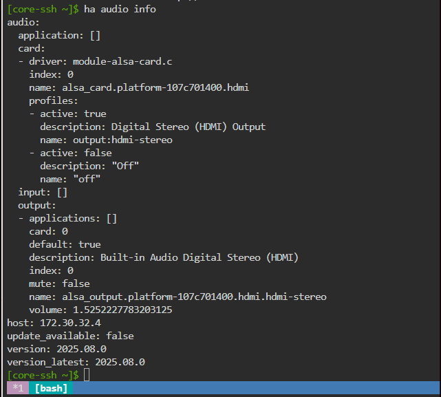

My problem is, I can’t get any sound to come out of the speakers, the Pi is connected using a mini HDMI to standard HDMI.
ha audio info shows the following:

    • change audio options output value to Built-in Audio Digital Stereo (HDMI) value. It should be in the list, based upon your ha audio info details.
