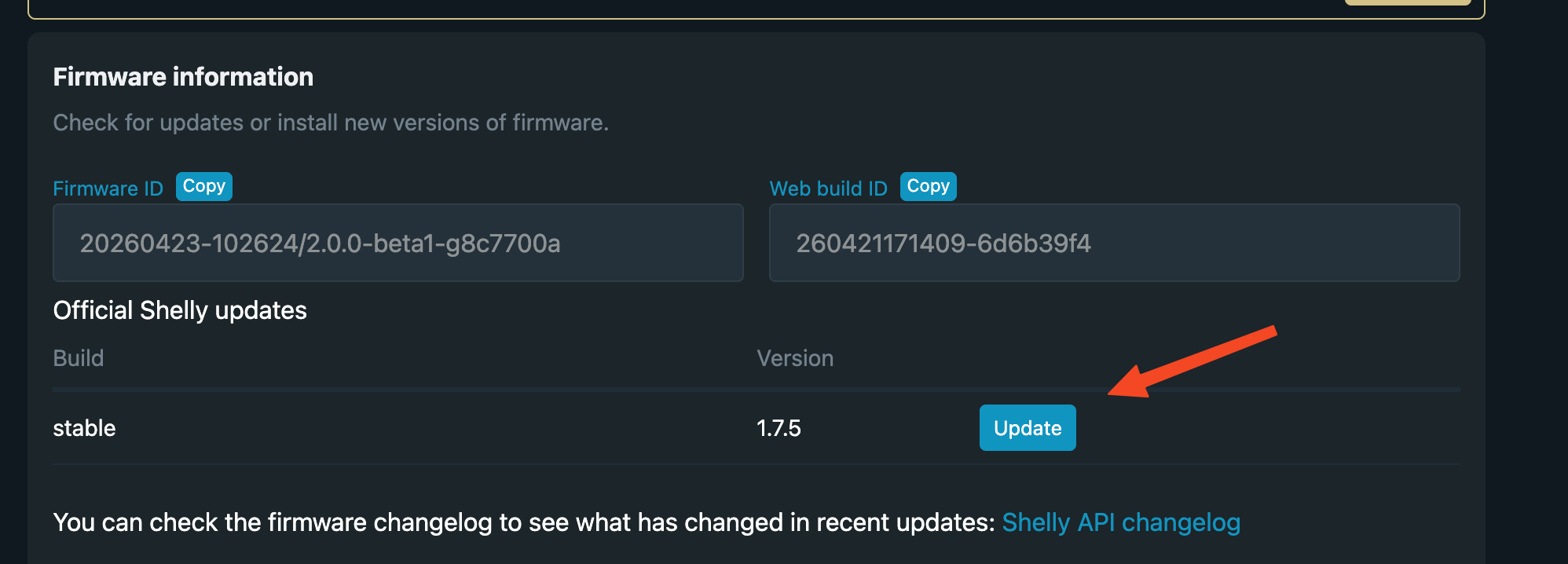

I am experiencing the same problem, but unfortunately cannot find a solution. How did you downgrade the firmware?
Under Settings → Firmware you can simply “Update” to the version 1.7.5:
Well this is not fixed and we are on 2.0 stable now. Seems to be downgrade is not possible anymore.
