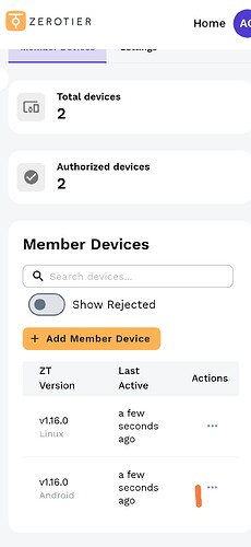

Both devices, android phone and HA are authorised in zerotier and seen/connected in the webapp. But no connection when wifi is disabled on the phone. Addon is running and all is started in logfile. I don’t know where to search.

Both client (phone) and addon (HA) configured as private on zerotier. Authorised and both have connection with zerotier.

Even did deleted network on zerotier and made a new one with new ID. Both devices authorised in zerotier.
