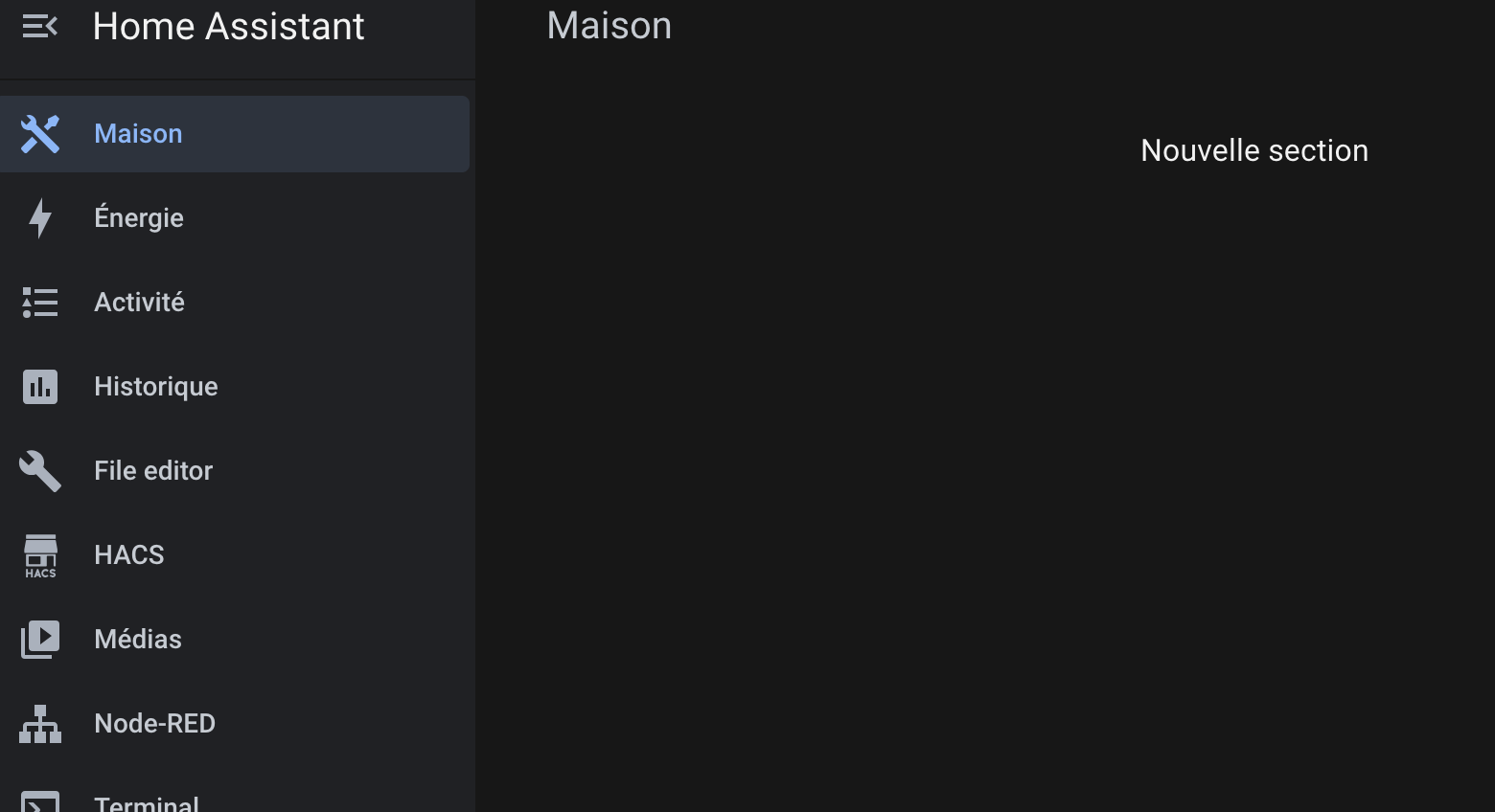

No dashboard displayed but "Nouvelle section" (new section)
Hi
I installed HA core 2026.9.2 today and I tried to migrate my views using Sections.
The result : Only “New section” (Nouvelle section in french) is displayed. I search during some hours but I cannot find a solution.
Below interessant files:

When I reload the view (with three points + Actualiser/reload) et shift reload of the navigator I have the following:
Have you an idea ? I’m lost :frowning:
Many thanks
ok after a total reboot ! Lol !
