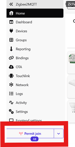

Zigbee2MQTT shows the dongle as connected no errors in the logs about the connection. But when I click “Start pairing”, absolutely nothing happens. No devices, no join attempts, nothing.
For comparison: the exact same devices are instantly picked up by my Hue Bridge. So the devices are definitely broadcasting.
Have you clicked “permit join”?
Yes I have tried that I am looking at every setting now but cant find the problem.
