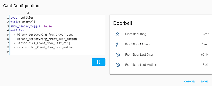

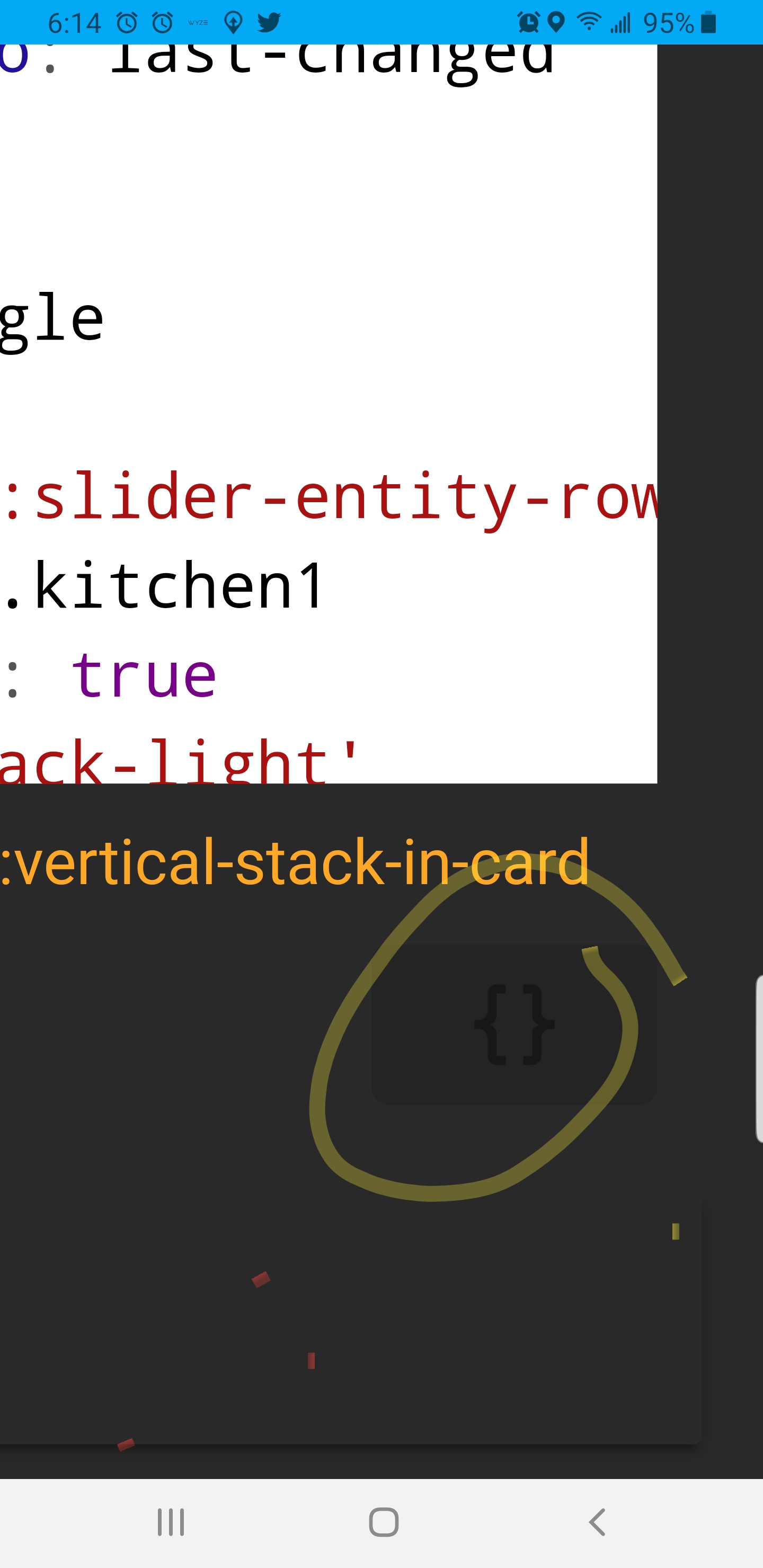

ALSO- You cant tell me these brackets are intentional??
Whats actually happening here?
FFS, you’re talking about the preview? That could be a bug. UI editing does not equal preview. Example of UI editing:
That’s a greyed out button that switches between yaml and UI. That’s available when you can use a GUI for editing. It’s not available in your horizontal stack.
UI editing (Button unpressed)
YAML Editing (button pressed)
And further more, I just verified that horizontal/vertical stacks preview still works. So as @Tinkerer said, this is because of your custom cards.

Ha! I too have seen this message, new @ 0.98, and the braces. I had no idea those braces were actually a button. Is this documented somewhere? It’s not very intuitive…
Doesn’t appear to be. It’s used to have the name ‘Toggle Editor’. I just created an issue to have it renamed to ‘Toggle Editor’.
