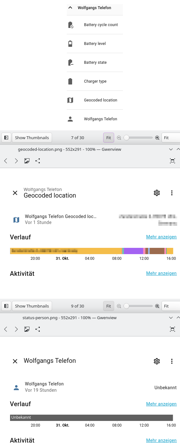

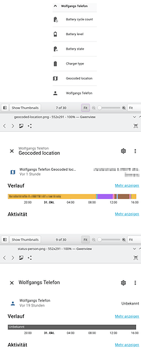

that was a good idea to check the other sensors. I see the following
All sensors update. These are the available ones, see top part of the screenshot.
The sensor geocoded location know where I have been, see middle part of the screenshot
But the sensor for the person is unknown all the time, see bottom part of the screenshot.
I don’t see a sensor which would report the “raw gps position”. I also don’t see such a sensor in the companion’s app sensors management page. Is that to be expected?
The geocoded location sensor can’t be selected when configuring a geo-tracker in the Person configuration page. What is going on?

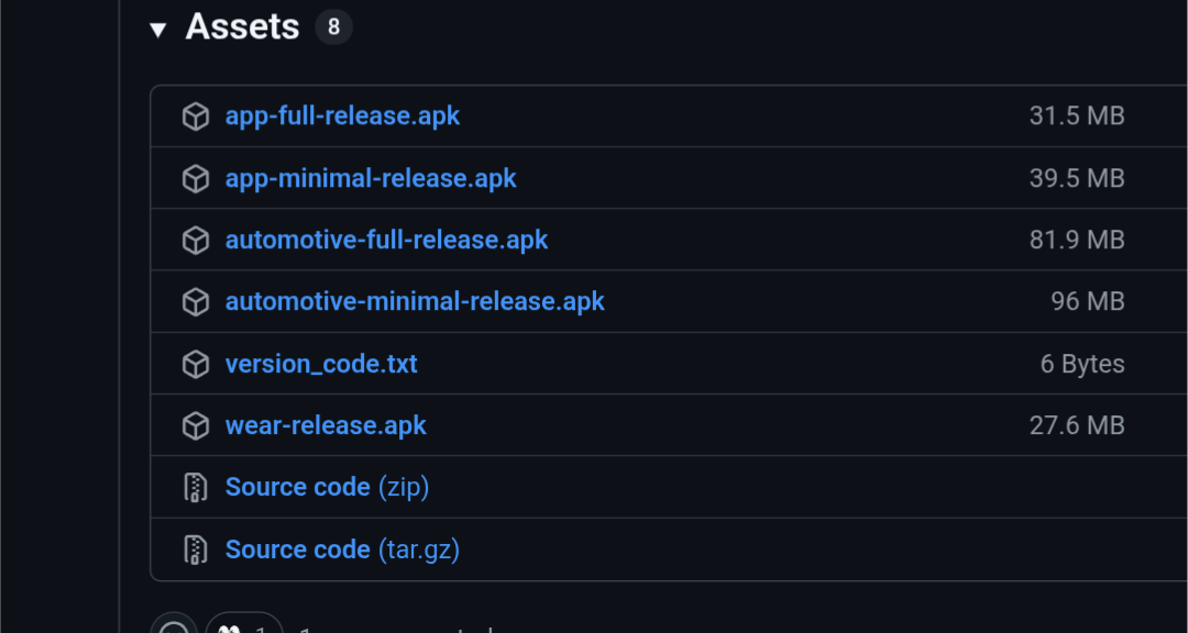

There is no location tracking offered on the minimal version found on f-droid. It’s also mentioned in the app description on their store listening.
This is 100 percent correct. Minimal version lacks play services like location tracking. Download the full version from GitHub and sideload it.
The Android Android app is being offered in 2 different flavors as either full or minimal. The full flavor of the app is offered via \\∆ explain the Play Store and has the full set of features offered as it requires Google Play Services. The full flavor is offered for both production and beta releases.
The minimal flavor of the app does not require Google Play Services and is available in the releases section on GitHub as an APK. It can also be installed from F-Droid. However, updates may be delayed because F-Droid builds new releases independently. This flavor does not support location tracking. Additionally, the following sensors are unavailable: Activity sensors.

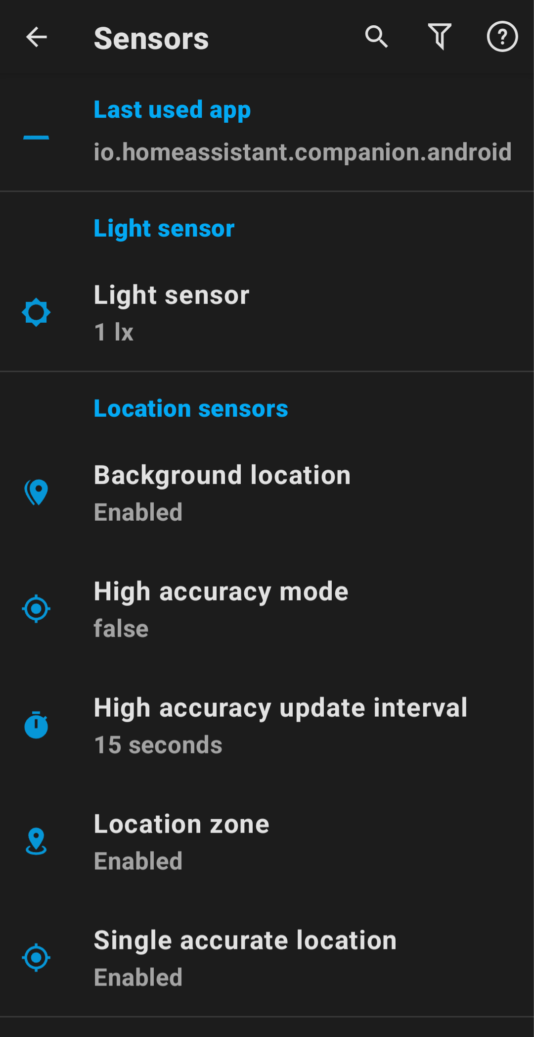

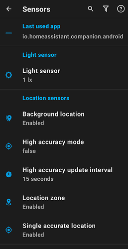

Do you have background location enabled in settings>companion app> sensors? I’m pretty sure it is disabled by default. You can also set the frequency to save battery life or update instantly. You can also setup Google Geocoded location to get human readable addresses. Google charges me 1 cent a.month. I don’t know exactly what the number of free API calls you get a month but I’ve never been charged. Device tracker needs to be setup for it to work.
OMG @ginandbacon thank you so much. That’s it! I have activated the background permission in the android system settings for the HA App but didn’t recognize that there is a setting in the app as well.

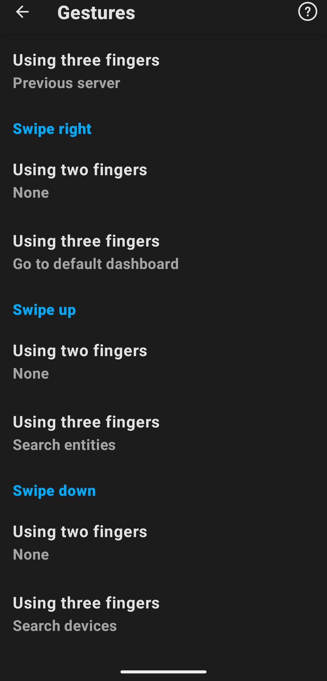

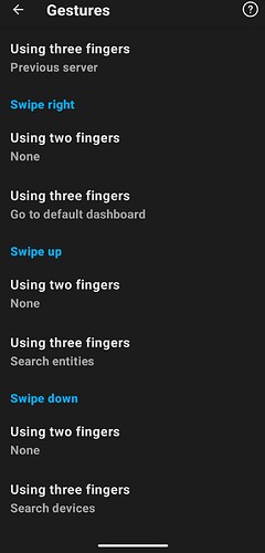

No problem at all. Good to check the companion app every once in a while. The new features don’t always get a lot of attention like gesture shortcuts you can define. Great for bringing up the 3 keyboard shortcuts e, d and c. Saves a lot of noise or touch navigation.
