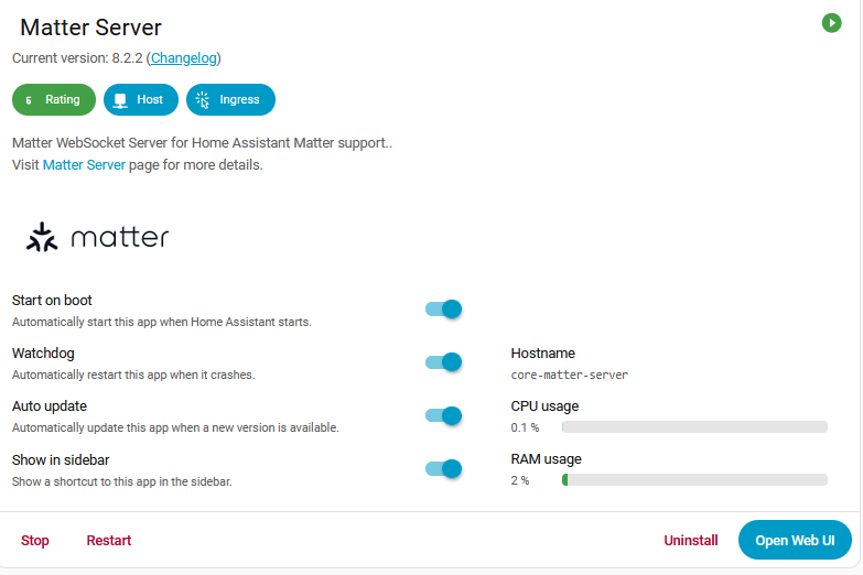

Matter Server is running:

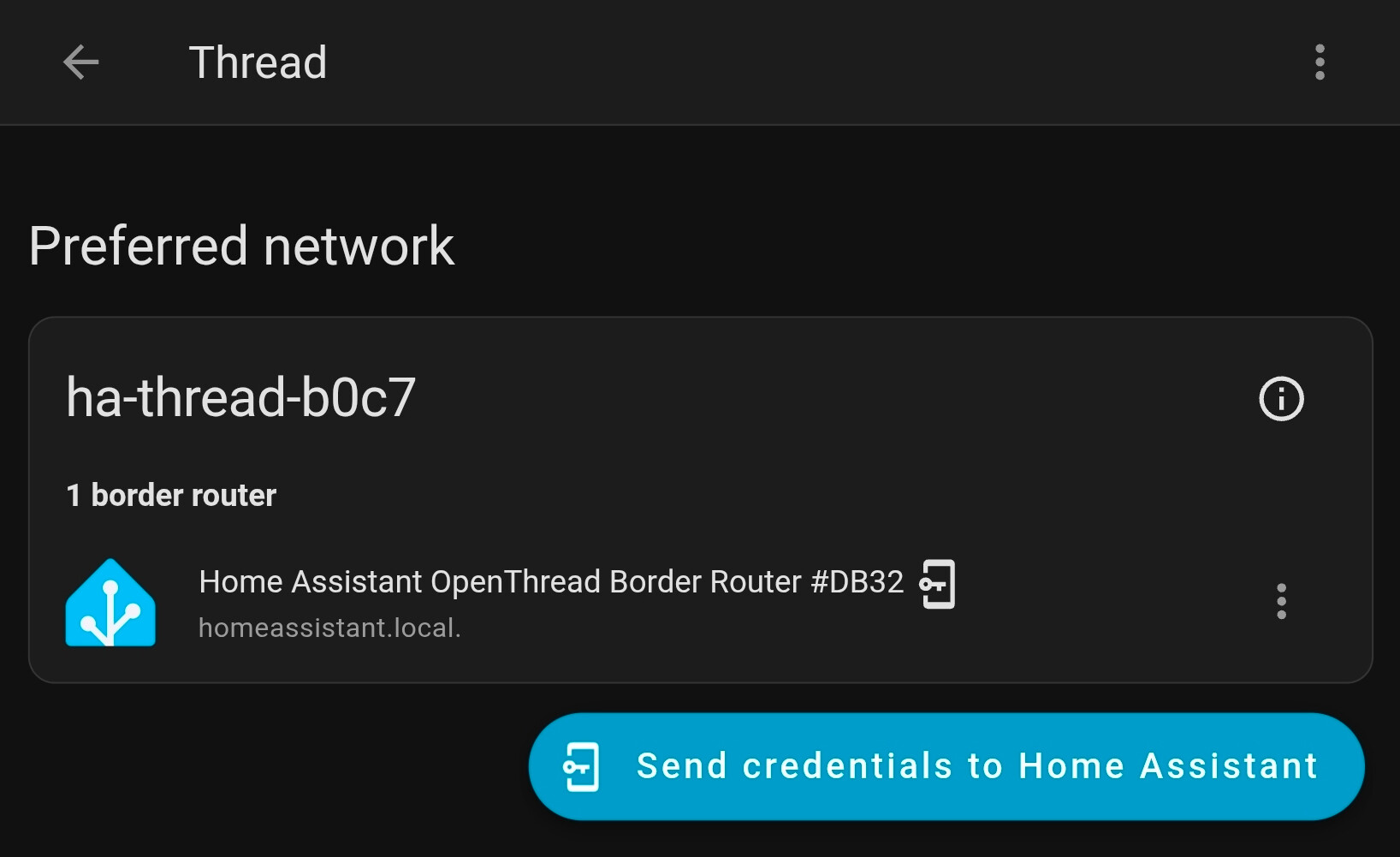

But I see my thread border router on HA:
ChatGPT said, I must see a Matter Controller. But no matter what I try, the Matter Controller does not appear?

Hi, thank you for your hint.
I have an Android smart phone with HA App and I see this:
So I see the button “Send credentials to Home Assistant” and not “Receive credetials from Home Assistant”!?
Is this wrong?
Regards
Michael
That is the network HA sees and have selected.
The credentials for that network needs to be synced to you phone, which is done in the companion app on your phone.
