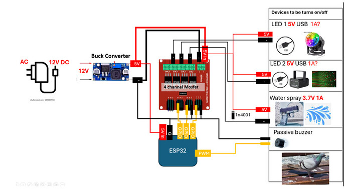

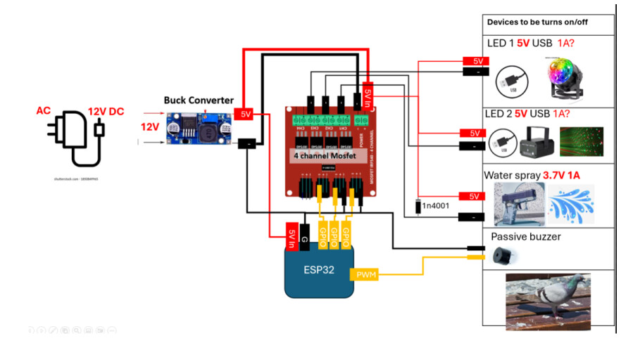

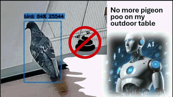

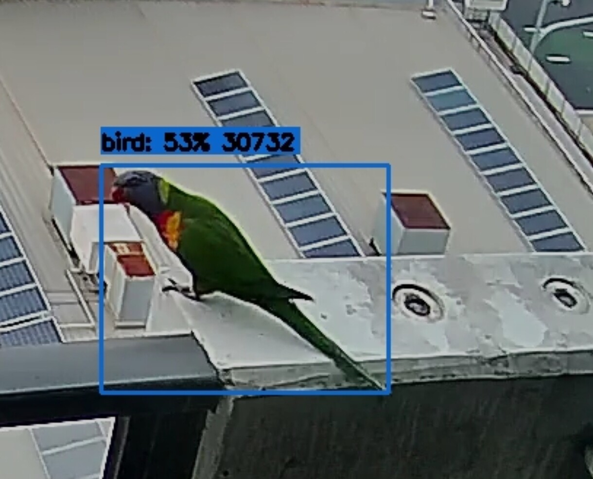

No more pigeon poo on my outdoor table
I’m using Frigate to detect pigeons and a DIY ESPHome device to scare them.
It’s been working great so far.
Thanks to ssieb and nkinnan over on Discord for some wiring advice a while back.
PromoVid_Small-ezgif.com-resize
Overview of deterrants which get triggered…

I understand you perfectly, pigeons are my kryptonite
(oooo-ooo oo-oo gruu-gruu)

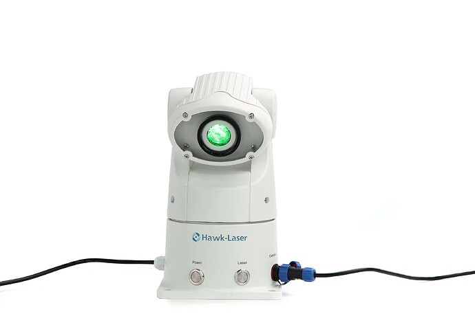

Please do not connect high power lasers to this device to blind them.
It’s just one of these low powered ones :wink:
The idea was to copy this kind of approach.
Not sure how effective that aspect of it is to be honest.
The water spray which also makes a pretty loud ossilating mechanical noise seems to be the most effective.
The lasers aren’t so visible during daylight. Perhaps they will help in winter or for would be overnight roosting.

I decided to start with a simple passive buzzer which makes a bunch of “possibly annoying but that’s unconfirmed” noises targeted at thier audio range (or so my AI developer says).
I might put a speaker out there later if needed. I actually got some Atom Echo’s to play with but they are too quiet.
One thing I was reading online is that pigeon’s through either thier intelligence or dumbness, bascially figure out pretty quickly where there is a real threat and also get used to things. So I tried to add a fair bit of variety to my scares and add a bit of randomness to it all. Maybe that helps.
For now the noisey water psitol seems to be the real winner.

I rarely get birds besides pigeons on my balcony but just had my first collateral.
I did look at Frigate species detection but it doesn’t seem to be that reliable.
