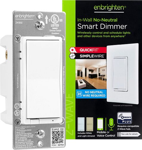

Zwave switches & dimmers are available that don’t require a neutral. The work by not completely turning off the circuit, and so the downside is that some LED lights may dimly flicker when they are supposed to be off.
GE switch that doesn’t require a neutral:

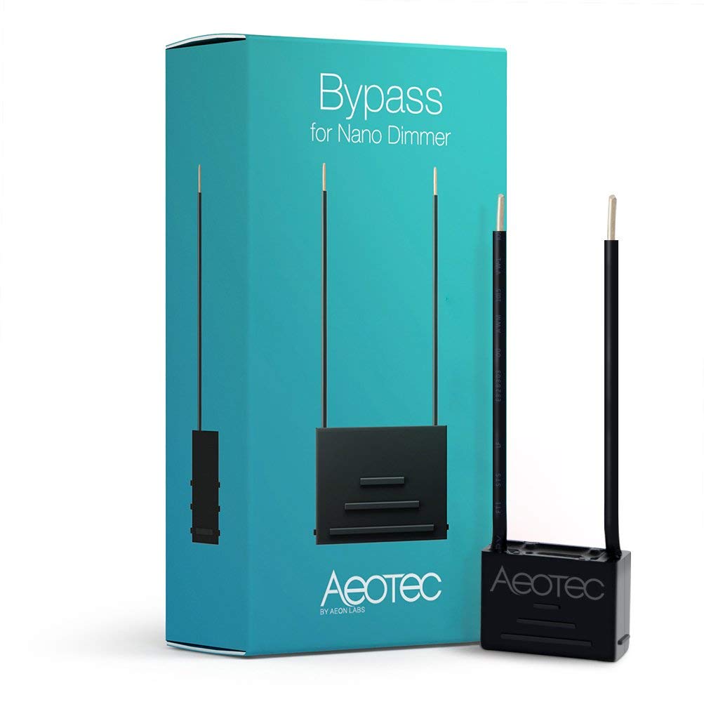

If you have flickering issues, wire in a bypass load:
Where does it say it does not require a neutral? It has a neutral post. @mekaneck

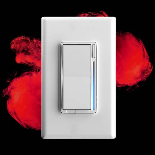

Sorry that was the wrong link. Here is the GE version that does t require a neutral, but is currently out of stock. There are other brands that offer the same functionality though:
Edit: here is the Innovelli option, but also out of stock:
I can’t find anything. I’m gonna try and get a neutral pulled.
