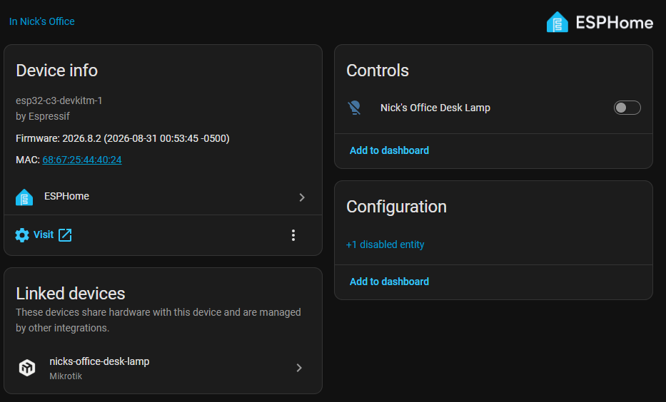

Instead of spending a couple hours doing this to my bulbs, I wasted an entire weekend reverse engineering and developing a procedure that hijacks the factory test mode to wirelessly load firmware onto the bulbs.
  • All you need is an ESP32S3 (no wiring)
  • No home network access required
  • Delivers my wyze-loader payload, which hosts an AP that allows you to upload an ESPHome OTA image using my provided config
