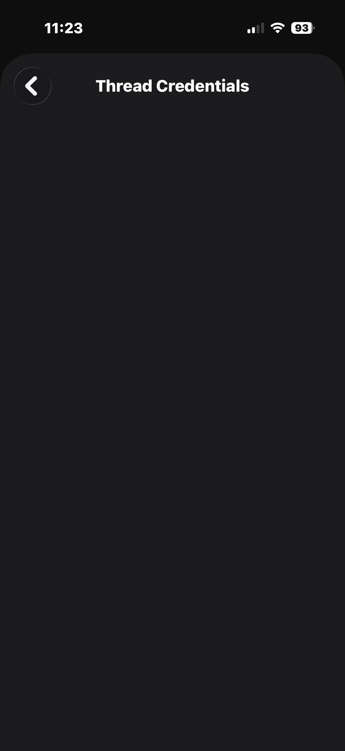

I purchased some IKEA matter devices and was trying to add them to Home Assistant. When I try to add them I get a “Failed to save network credentials” error.
When I got to Settings → Companion App → Debugging → Thread, there is no border router listed and the page is blank.
Going to the Thread option I try to send the credentials to the phone I get “no border router defined” and when I send the credentials to HA I get “No preferred router found”
I have been able to add matter devices before to HA and have no idea where the preferred border router disappeared to.
