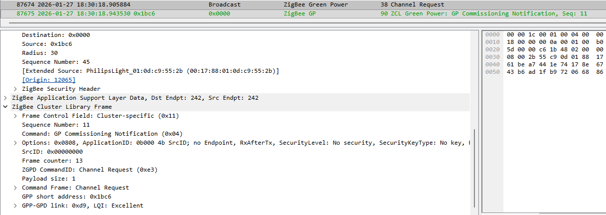

I have an acti9 powertag (temperature sensor) that is GP-only, and that I wanna add to my network.
But I just can’t pair it.
I have never added a zgpd into my network before through Z2M, so this is my first time. But it works just fine using a custom CLI.
What did you expect to happen?
After I reset my sensor by holding a button for 3 blinks, a Channel Request is sent, the proxy picks it and sends it up in a Commissioning Notification (picture attached).
But there is no response.
I put logs on debug level, but they’re very minimal. I can’t see everything.
I tested on the dev branch, same thing, no response from the sink.
Insert picture here
