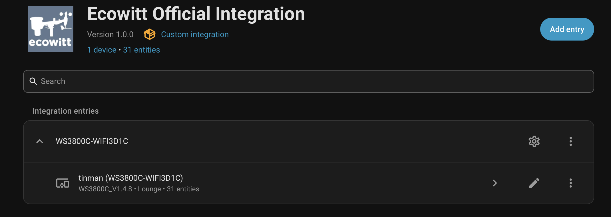

… went looking i developer… figured everything looks as if it is pre pended by ‘lounge_tinman_ws3800c_wifi3d1c’ so added that as the exclude

I find the easiest way to see a list of entities for an integration is using Tools > Template editor with this template (I’m assuming Ecowitt is actually named ecowitt):
{{ integration_entities('ecowitt')|to_json(pretty_print=true) }}
That gives you a nice vertical list of entities to compare.
I don’t know what ‘tinman’ is but lounge definitely looks like an area name prepend, avoid hardcoding those in case you ever change the room it’s in and appropriately update the entitiy id’s. Try *.*_ws3800c_wifi3d1c*
