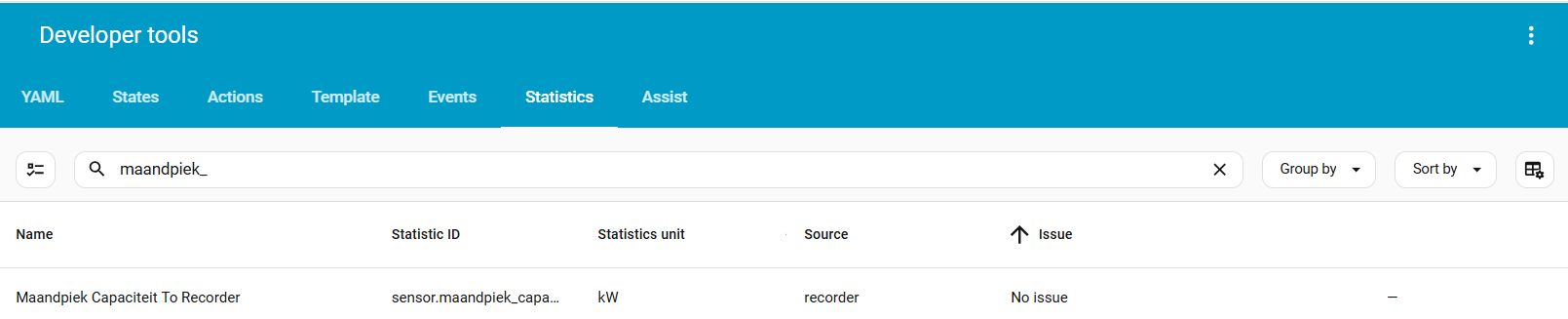

But I don’t get statistics for the last one (all this configurated a month ago, so yes input_number.number_maandpiek_capaciteit had changed several times) :
It’s the only one with this :
      state_class: measurement
      device_class: power
I don’t know if this is the reason ?
I want to be able to get a graph with maximum values pro month…
Nobody who can help me ?
