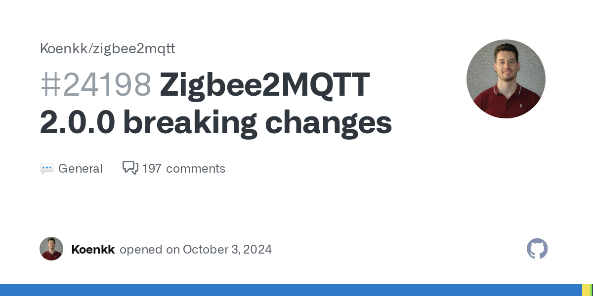

Did you read this:
sooo this was missing:
homeassistant:
  legacy_action_sensor: true
