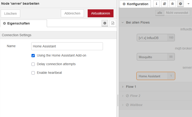

*) Enabling heart beat in the node-red homeassistant server setting
*) Disabeling the usage of the HA add-on and entering URL and token manually

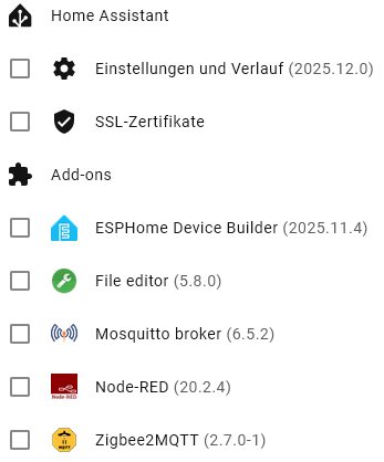

My HA is runing directly on an Intel NUC (no containers, VMs, etc). Node-red is an add-on in HA. Everything is up to date:

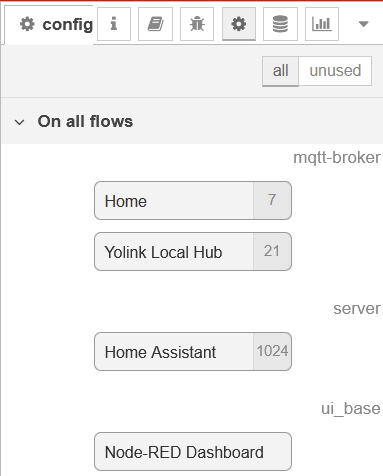

If you go into NR, then the “three lines” icon in the upper right, then Configuration nodes, is there just one entry under “server”?
Thanks you for your super fast response :slightly_smiling_face:
Yes, I have rebooted several times.
The only entry is homeassistant
Well, lol, the fast responses are about to stop, because I’ve reached the limit of my troubleshooting :slight_smile: The only difference I have on my config is I have the check mark set for “Delay connection attempts”. You could try setting that. Beyond that, I’m not sure what else to suggest, and hopefully someone with deeper knowledge can jump in to help!

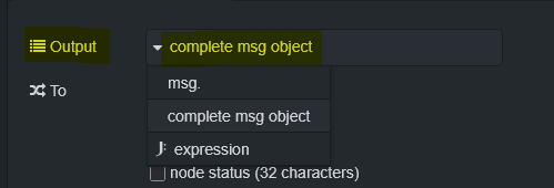

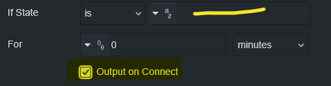

Could you pull out an event state node, select an entity. Leave the if state blank and check output on connect.
Connect that to a debug node and set the debug to complete msg object
and deploy
