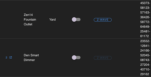

At this time all nodes seem ok. But one thing that is different is some of my devices on the provisioning (Smart Start) ZUI page don’t show their associated node IDs.

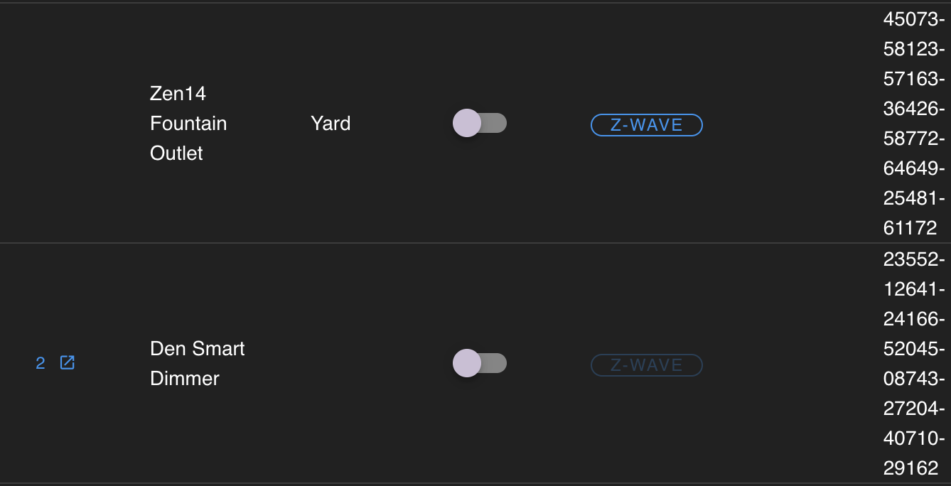

Note how the “Zen14 Fountain Outlet” isn’t showing its node id:
41 of my 68 nodes on that Smart Start/provisioning page are not showing a node id. (Most of those are the nodes that I had to re-interview after moving to the new controller.)
Why is ZUI (or z-wave js) not seeing those? I assumed they were linked by the DSK.

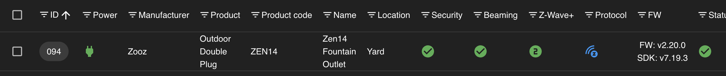

That zen14 device above is node 94:
