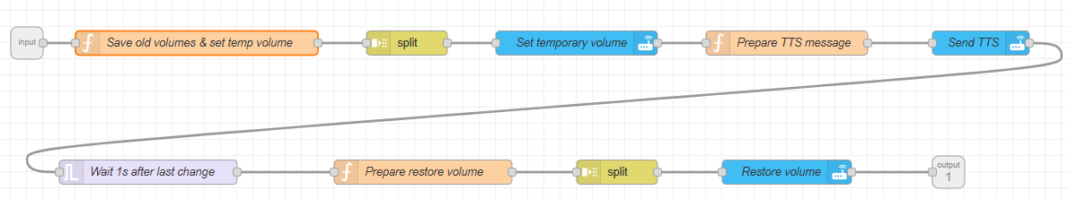

I had quite a few issues (ad hoc but it became too much and I also like to tinker) with Applestrudle. One time password with Amazon etc so I looked for another way to announce to use my speakers.
If you want sounds you can get them from here Alexa Skills Kit Sound Library | Alexa Skills Kit
I wanted to be able to announce on my speakers and then set the volume back to what it was before. To achieve this I created a subflow where I pass in the message and volume
eg I used a get entities node to get my speakers (I used a group so it’s easy to control) then a function to store the speakers and message to be announced
Pass that into the subflow where it performs 3 things
  1. Save existing volumes and sets the new volume
  2. Prepare the message
  3. Restore the volume
Here’s the subflow

And the flow to pass the data into the subflow
        "id": "8dae10acf570a6e9",
        "type": "subflow",
        "name": "Alexa Message and Volume",
        "info": "",
        "category": "",
