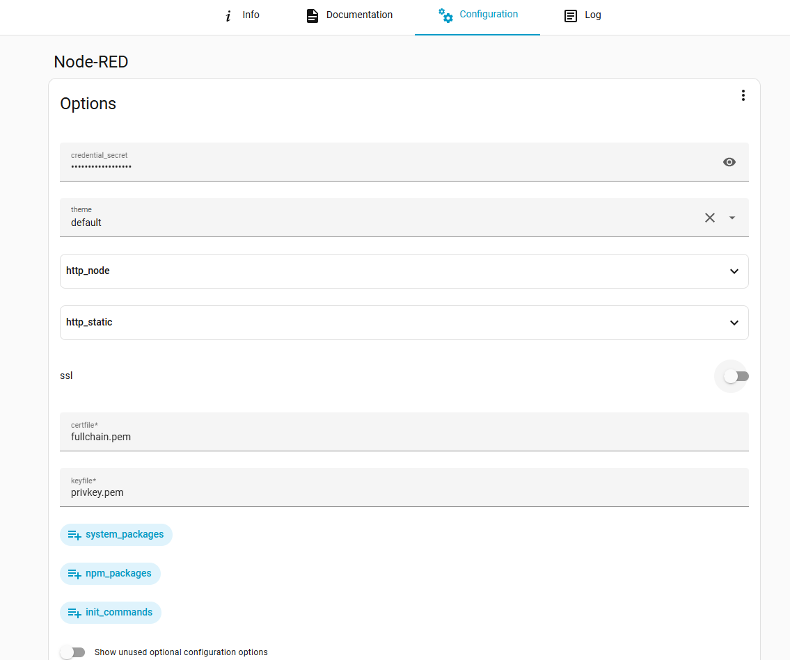

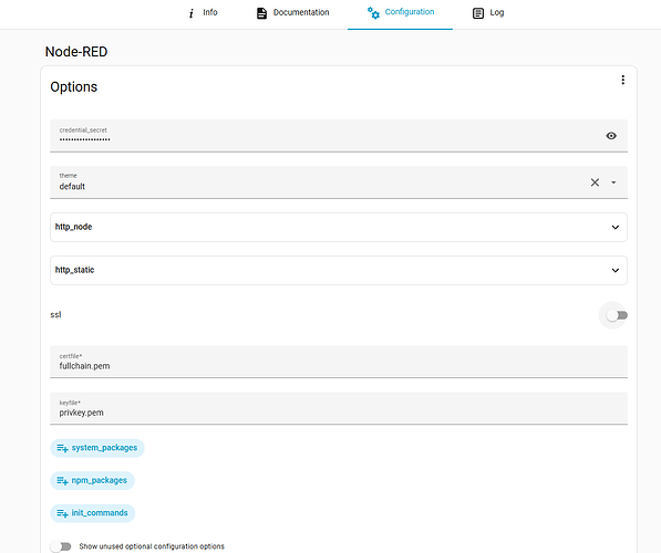

The option for ssl should be in the Node-RED App configuration setting UI page
This screenshot may not reflect the latest version: certainly the credentials secret option was removed some time ago.
The NR App has many of the standard settings either removed, modified, or controlled from the App Configuration page. I installed Node-RED many years ago, so I cannot comment on the current default settings, but ideally the ssl option should be off.
If you ever need access to the underlying settings.js file, you can find this in the addon_configs HA folder:
addon_configs\a0d7b954_nodered\settings.js
Modifying this file is required for only a few specialist ‘extra options’ such as turning on file-persistent context memory, adding a credential password, or changing the order of the palette nodes in the left hand pick list in the NR editor.
IF you ever do change the NR settings file
  • keep a backup first
  • do not change any of the App specific removed or UI set options
Thank you very much. I was able to update the button and NR 4.1 gave me a welcome. Thank you.
