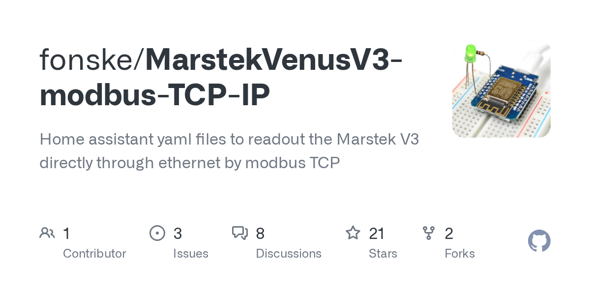

What i want to install is following link:
So i first opened the readme, in the main config yaml file i added the block.
Than i have to create a subfolder “packages”. Is it a subfolder in home assistant or is it a subfolder under configuration yaml? not clear for me.

In that folder paste the yaml files.
You will also edit configuration.yaml to add these lines, as the repo says.
homeassistant:
  packages: !include_dir_named packages
This is word for word from the directions in the repo.
Check configuration and restart home assistant after editing the packages stuff.
