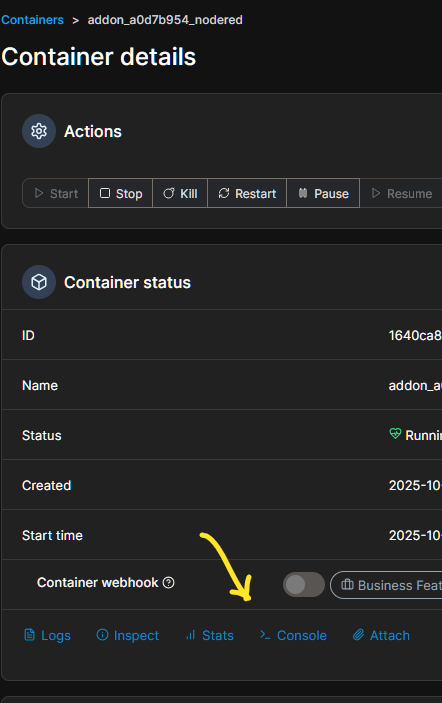

You’ll need to get to the command line of the node red addon. The easiest way to get there is to install this version of portainer. From the gui browse to the nr container and choose console.

No portainer you do not need to change any settings, leave the default. Log in use admin for the user and homeassistant for the password. The default password homeassistant can be changed on the configuration tab.
