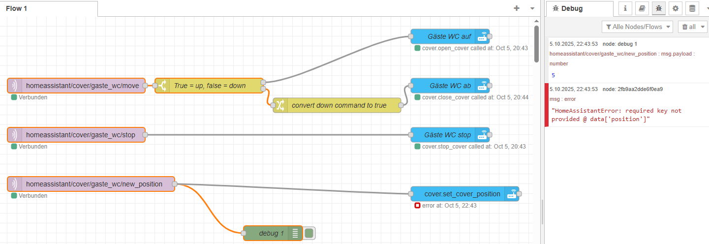

I do not understand why the set cover position is not working. The input number is normalized to 0-100 in the underlying system already and received via mqtt.
The action node to set cover position is in default config beside the target item. Would someone please help me? Thanks a lot!
The data section needs a value for position: a number between 0 and 100.
"position": 50
