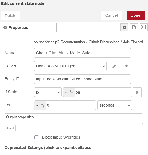

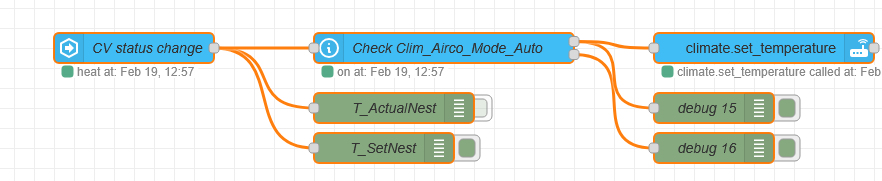

Node Red Set data only when Current state is true
I want to set the air conditioning temperature based on my CV temperature, but only when my input_boolean is true/on. I assume I can do this with a Current State node.
So far I have a setup, but no matter the state of my input_boolean, it will always be false.
Any idea what I am doing wrong?

        "type": "api-current-state",
        "z": "tab_zonne_airco",
        "name": "Check Clim_Airco_Mode_Auto",
        "server": "62b7e1da.0d003",
        "version": 3,
        "outputs": 2,
        "halt_if": "on",
        "halt_if_type": "str",
        "halt_if_compare": "is",
        "entity_id": "input_boolean.clim_airco_mode_auto",
        "state_type": "str",
        "blockInputOverrides": false,
        "outputProperties": [],
        "for": "0",
        "forType": "num",
        "forUnits": "seconds",
        "state_location": "Clim_Airco_Mode_Auto",
        "override_payload": "none",

Check the “block input override” box in the current state node.
