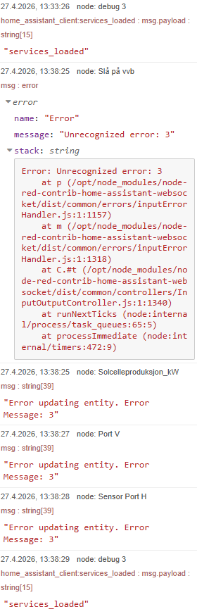

For some time I have been getting error messages in NR such as “Unrecognized error 3” or “Error updating entity”. Sometimes everything works, but then these error messages re-appear.

Error messages in NodeRED
NodeRED logs:
27 Apr 13:38:25 - [error] [ha-entity-config:Sensor Port H] Error updating entity. Error Message: 3
27 Apr 13:38:25 - [info] [server:Home Assistant] Connection closed to http://supervisor/core
27 Apr 13:38:25 - [info] [server:Home Assistant] Connecting to http://supervisor/core
27 Apr 13:38:25 - [info] [server:Home Assistant] Connected to http://supervisor/core
27 Apr 13:38:25 - [debug] [server:Home Assistant] States Loaded
27 Apr 13:38:25 - [debug] [server:Home Assistant] Services Loaded
27 Apr 13:38:25 - [debug] [server:Home Assistant] Integration: loaded
27 Apr 13:38:25 - [debug] [ha-entity-config:sensor config for Info fra PS til HA] Registering sensor with HA
27 Apr 13:38:25 - [debug] [ha-entity-config:ev_lader_setpunkt] Registering sensor with HA
27 Apr 13:38:25 - [debug] [ha-entity-config:weather cloudyness] Registering sensor with HA
27 Apr 13:38:25 - [debug] [ha-entity-config:Port V] Registering sensor with HA
27 Apr 13:38:25 - [debug] [ha-entity-config:Sensor Port H] Registering sensor with HA
27 Apr 13:38:25 - [debug] [ha-entity-config:Solcelleproduksjon_kW] Registering sensor with HA
27 Apr 13:38:25 - [debug] [server:Home Assistant] HA State: running
27 Apr 13:38:59 - [debug] [api-call-service:Slå på vvb] Calling Service: {"domain":"light","service":"turn_on","target":{"entity_id":"light.vvbereder_light"}}
27 Apr 13:38:59 - [debug] [api-call-service:Slå av vvb.ps hjelper] Calling Service: {"domain":"input_boolean","service":"turn_off","target":{"entity_id":"input_boolean.vvb_ps_overstyring"}}
27 Apr 13:38:59 - [debug] [api-call-service:Slå av vvb overstyr hjelper] Calling Service: {"domain":"input_boolean","service":"turn_off","target":{"entity_id":"input_boolean.vvb_overstyr"}}
27 Apr 13:42:03 - [debug] [api-call-service:Deaktiver hjelper: negativ strømpris] Calling Service: {"domain":"input_boolean","service":"turn_off","target":{"entity_id":"input_boolean.negativ_strompris"}}
27 Apr 13:42:09 - [debug] [api-call-service:Soloverskudd nivå 1 PÅ] Calling Service: {"domain":"input_boolean","service":"turn_on","target":{"entity_id":"input_boolean.soloverskudd_niva_1"}}
27 Apr 13:42:09 - [debug] [api-call-service:Soloverskudd nivå 2 PÅ] Calling Service: {"domain":"input_boolean","service":"turn_on","target":{"entity_id":"input_boolean.soloverskudd_niva_2"}}
27 Apr 13:42:09 - [debug] [api-call-service:Soloverskudd nivå 3 PÅ] Calling Service: {"domain":"input_boolean","service":"turn_on","target":{"entity_id":"input_boolean.soloverskudd_niva_3"}}
27 Apr 13:43:22 - [trace] comms.close 5TBzLd9qIE7XbTiEjm0nGkBauxsU/wzxl01ZgFVDXi4=
27 Apr 13:43:22 - [trace] comms.open edxH1xIzz15zwg46jCtuigi328SZnE7wfXafq722RAw=
27 Apr 13:43:22 - [error] [ha-entity-config:Solcelleproduksjon_kW] Error updating entity. Error Message: 3
27 Apr 13:43:22 - [error] [ha-entity-config:Port V] Error updating entity. Error Message: 3
27 Apr 13:43:22 - [error] [ha-entity-config:Sensor Port H] Error updating entity. Error Message: 3
27 Apr 13:43:22 - [info] [server:Home Assistant] Connection closed to http://supervisor/core
27 Apr 13:43:22 - [info] [server:Home Assistant] Connecting to http://supervisor/core
27 Apr 13:43:23 - [info] [server:Home Assistant] Connected to http://supervisor/core
27 Apr 13:43:23 - [debug] [server:Home Assistant] States Loaded
27 Apr 13:43:23 - [debug] [server:Home Assistant] Services Loaded
27 Apr 13:43:23 - [debug] [server:Home Assistant] Integration: loaded
27 Apr 13:43:23 - [debug] [ha-entity-config:sensor config for Info fra PS til HA] Registering sensor with HA
27 Apr 13:43:23 - [debug] [ha-entity-config:ev_lader_setpunkt] Registering sensor with HA
27 Apr 13:43:23 - [debug] [ha-entity-config:weather cloudyness] Registering sensor with HA
27 Apr 13:43:23 - [debug] [ha-entity-config:Port V] Registering sensor with HA
27 Apr 13:43:23 - [debug] [ha-entity-config:Sensor Port H] Registering sensor with HA
27 Apr 13:43:23 - [debug] [ha-entity-config:Solcelleproduksjon_kW] Registering sensor with HA
27 Apr 13:43:23 - [debug] [server:Home Assistant] HA State: running
