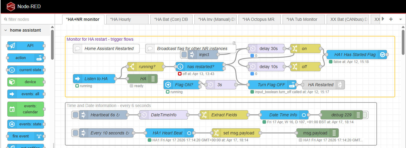

The flow, when set up correctly, works perfectly.
An HA restart, without a full machine restart, does not restart the running Apps, so Node-RED continues to run [hence any inject nodes set to trigger on NR restart will not fire] and this flow can be used to refresh graphs etc.
The flow, as provided, includes manual option for creating the necessary boolean switch and automation in Home Assistant, however you can follow the instructions and do this manually.

The only bits that I have ‘simplified’ have been to remove the auto-generate code for building the automation and input_boolean (and sub-flow) which I prefer to do by hand myself. The flow executes and monitors a specific sequence of triggers and events and cannot really be further simplified.
As far as I understand the flow, it works in two parts.
In Home Assistant
A. The automation “home assistant restarts” is triggered by the Home Assistant restart. The standard list of triggers include ‘home assistant’ for when HA starts or shuts down, this automation uses the ‘starts’ trigger. The action then taken is to turn on an input_boolean (switch) “home assistant restarted”
B. The input boolean “home assistant restarted” is therefore set to ‘on’ by HA when HA restarts. However, this switch can also be turned on manually. Note too that any input_boolean retains the state (has it restored) by HA on restart, so if it was left ‘on’ before restart it will be restored to ‘on’ at restart [which we actually don’t want]
*Note: you have to add these bits yourself or use the code to do this for you. Create input_boolean “home assistant restarted” first before creating the automation
In Node-RED
The Events: all node listens for ‘home_assistant_client’ events, which are put on the event bus by HA and include events like ‘starting’ and ‘running’ and ‘ready’. When HA restarts, these events appear, and the node picks them up, with the Switch node filtering out just the event ‘running’ which is a good indication that HA has restarted and is now up and running.
Then the input_boolean switch is checked to see that it is ‘on’ which shows that not only has HA restarted, but the “HA restarted automation” has also run and set the switch.
Separately, the Events: state node listens for events on the specific “home assistant restarted” input_boolean switch. Set for if state as on, this node will therefore trigger a message if the switch has gone (from off or unavailable) to “on” [caused either by HA restarting or by a manual set to on]
The rest of the flow uses either of the two triggers, to use an Action node to turn the switch ‘off’, thus effectively toggling the input_boolean switch “off-on-off”, either from a manual turn-on or from the HA restarting automation turn-on.
Both triggers are required, and the switch must be reset to ‘off’ as part of the flow.
I would always [strongly] suggest using the flow from the link I provided. However here is a cut-down copy, with the code for creating the automation and input-boolean removed, and the nodes updated to the latest schema. You will need to add back your HA server, add the input_boolean entity-id you have used in HA, and then redeploy to update all the nodes.

I have tested this flow and it all appears to work correctly, but again the best route is to download the flow from the link and use that. I know that it generates a few warnings, but that is only because the node schemas have changed since this flow was first created, and all it requires is a re-deploy to update them.

You really need to ask Kermit, who wrote the flow, as to exactly what is going on.
The exact sequence of an HA restart can include a full machine reboot, with HA restarting, and the Node-RED (as an App) restarting later.
Last to come back up will be the WebSocket connection between HA and Node-RED. Since all the HA nodes require this connection, the HA automation will have run long before the flow is able to monitor it. Whilst the HA automation will have turned the input_boolean switch ‘on’, the Event: state node will also miss this. My guess is that the flow requires the Events: all to respond to a late-passed event to get the flow started. I think that the events are queued, and at NR restart the Homeassistant events that occur at start are returned.
There are several events associated with an HA restart - I don’t know which one the HA trigger is associated with, but Node-RED sees several before the “running” and finally “ready”.
The input_boolean switch has to be checked to ensure that any queued event is related to a real restart, rather than just getting the WebSocket connection restarted (which can happen at any time).
HA automations do not have a concept of ‘resetting’. An HA automation is triggered by an event (eg HA restart) and runs to completion.
If you want to know more then you will have to ask Kermit!
The events: all node is waiting for Home Assistant to reach its running state.
Home Assistant accepts WebSocket connections before it is fully started, so Node-RED can connect while HA is still loading integrations and restoring state. At that point, some entities, services, or integrations may not be available yet.
By waiting for the running state, you help ensure Home Assistant has finished startup and that most integrations and data are loaded and ready to accept commands.
