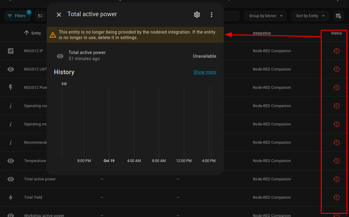

  1. When I go to settings - devices - nodered companion I can see there is a red exclamation mark next to every sensor node I have used in nodered that says “This entity is no longer being provided by the nodered integration. If the entity is no longer in use, delete it in settings.”

This is the component you need to update — the Node-RED Companion custom integration.
The latest version is 4.1.3, and you currently have 1.1.2 installed.

  • I was indeed running nodered companion 1.1.2 (settings - devices and services - nodered companion. You can see the version in that page).
  • This is a custom integration and is NOT updated automatically
  • If you create a backup in home assistant (settings - system - backups - backup now) the custom integration is NOT backed up. If you tru to restore, there is no checkbox ‘nodered companion’. I’m using zfs in truenas and was able to rollback a snapshot, but keep this in mind!
  • To update nodered companion, I could not update it via HACS. I got the error message nodered companion was already configured and I could have only 1 instance. Easiest way to update was manually by simply overwriting the files in /custom_components/noderred with the files found on github (Link Kermit provided) and restart home assistant.
