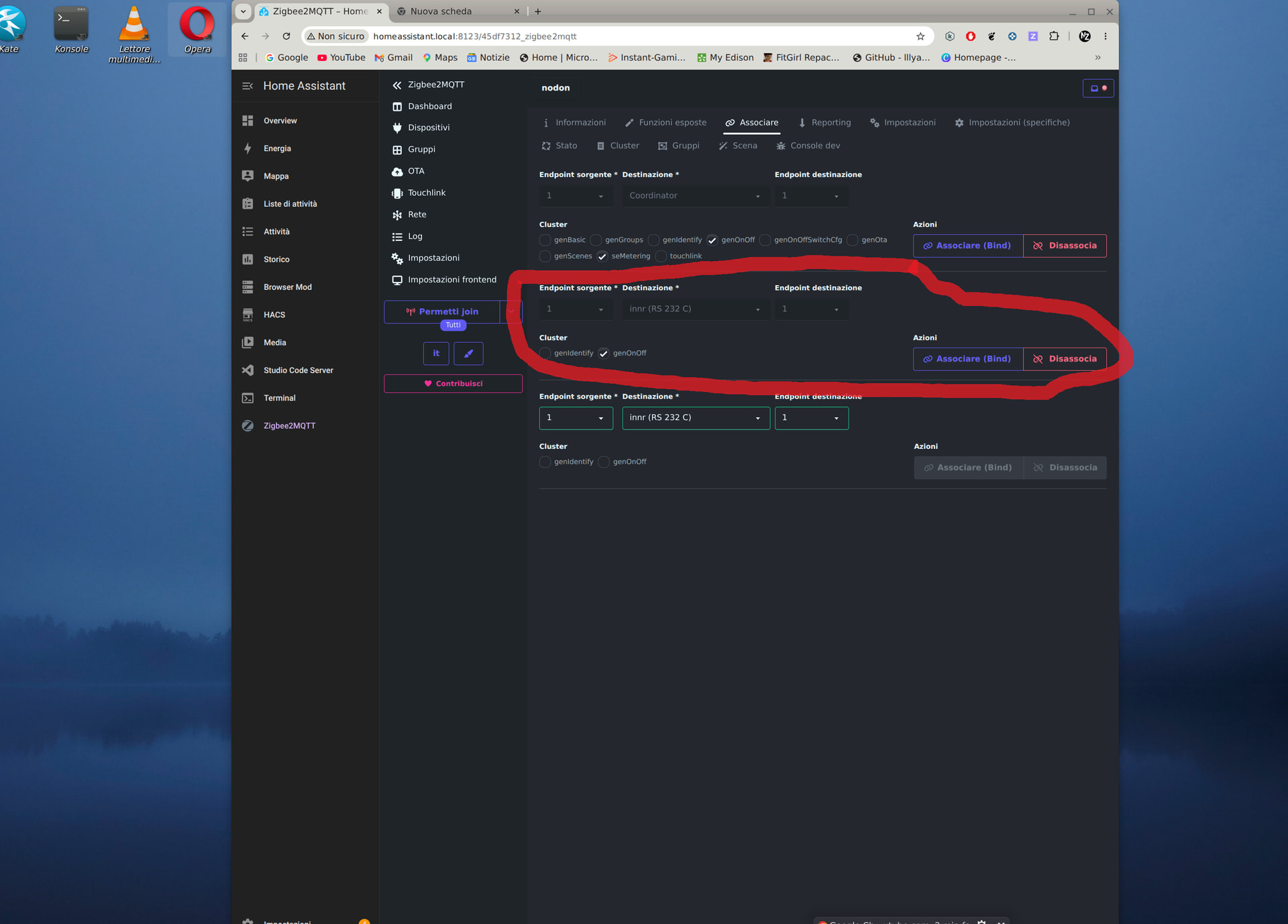

Good morning,
I'm looking for relays that support binding in Zigbee2MQTT. I have tested the Nodon SIN-4-1-21 Metering, which only supports binding to a single device because it exposes only the genOnOff cluster as an output cluster.
Does anyone know whether the Nodon SIN-4-2-20 relay, which is designed for lighting, exposes the genGroups cluster as an output cluster so that it can be bound to a group of lights?
P.S. I also tested the Shelly 1PM Gen4 with the 2.0 beta firmware. It supports binding to both individual devices and groups, but it still does not natively expose the option to choose between switch mode and push-button mode.
Thanks
