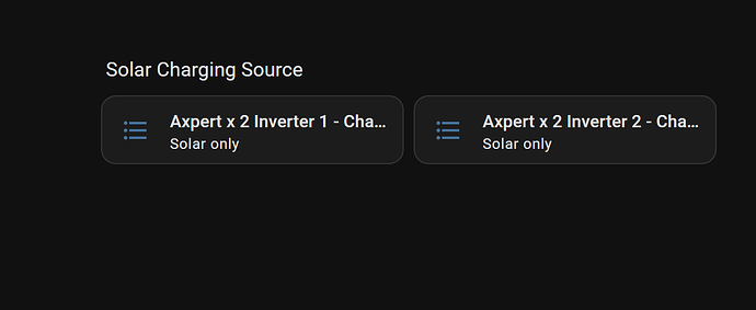

So, I have two inverters working in sync on my solar system, supplying power to my home. From time-to-time, for whatever reason, I may wish to switch from using solar-only to charge, to using solar-and-utility to charge (like maybe on a rainy day). That is a single drop-down in my solar app. But, there are two inverters, so I have to go to the app, find the setting one tab over, one page deep, and then select it. Then wait 10 seconds. Then do the same for the second inverter.
I would prefer to have ONE drop-down on my home assistant dashboard, which auto-opens when I go to HA (thus, one click so far, with one “selection” click). Yet, I do not seem to have the knowledge to figure this out.
At present, I have two “things” (I don’t know what you call them) on my dashboard, and, when I click any one of them, a new dialogue box opens up. On that dialogue box is the drop-down list that I ACTUALLY want to show on the dashboard. Here is a picture of the two things (buttons? links?).

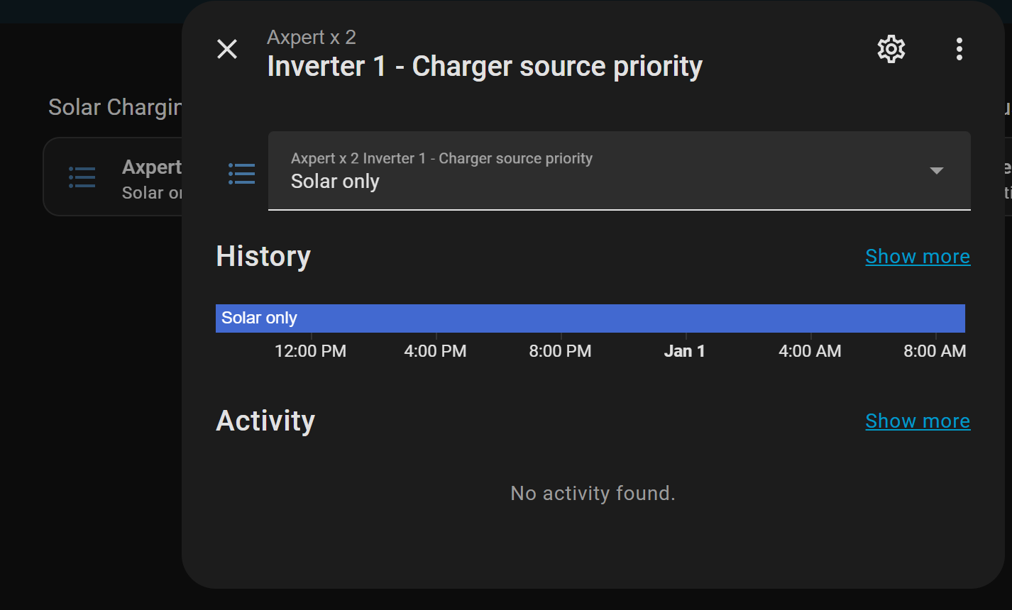

So, that’s what shows on my dashboard, and, from the little icon, one would assume that if you click it, it will show you a drop-down list…but no, it doesn’t it opens the new dialogue box. Here is the picture of the dialogue box that opens when I click on the left of these two “buttons”:

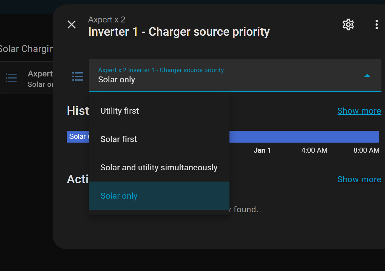

Please note the icon in the first image, and the icon in the second image - identical…they “imply” drop-down lists to my poor and limited knowledge. You can see on the second image that both icons show, one in the foreground and one in the background. Now, to me, this is helluva confusing, because I would assume these icons represent the same thing…but, apparently they don’t. :slight_smile:
Now, I can click on this new “button” again (which, this time, is a “real” drop-down list). And, I include the image below of what this looks like.
So, once I click one of those options, the change occurs…BUT, as you see in the names/titles of these buttons/drop-down lists, this is (as in the solar’s app) just for the one inverter. I have to do the same for the second one using that second button.

If you use the entities card instead of the entity card it will show the choices on the first click, I find this far more uasable.
Wait, let me be sure I am clear…entities vs entity, right?
Woah! Yeas, this makes a HUGE difference. It does exactly what I was hoping for :slight_smile:
