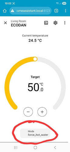

Anyway, here goes. Running Home Assistant on a Raspberry Pi. Gradually adding all my devices. Added MelCloud for my air to water Ecodan heat pump. Now, I would quite like a button to switch the hot water on for 1 hour. The problem is, that the button to do this is within an entity on home assistant. So this option it takes me to this screen:
And as you can see the button i want to activate is at the bottom.
Now I was under the impression that Ecodan was the Device but all the controls and sensors within the devices are the entities? So in theory, the tank target temperature and the force hot water should be different entities.

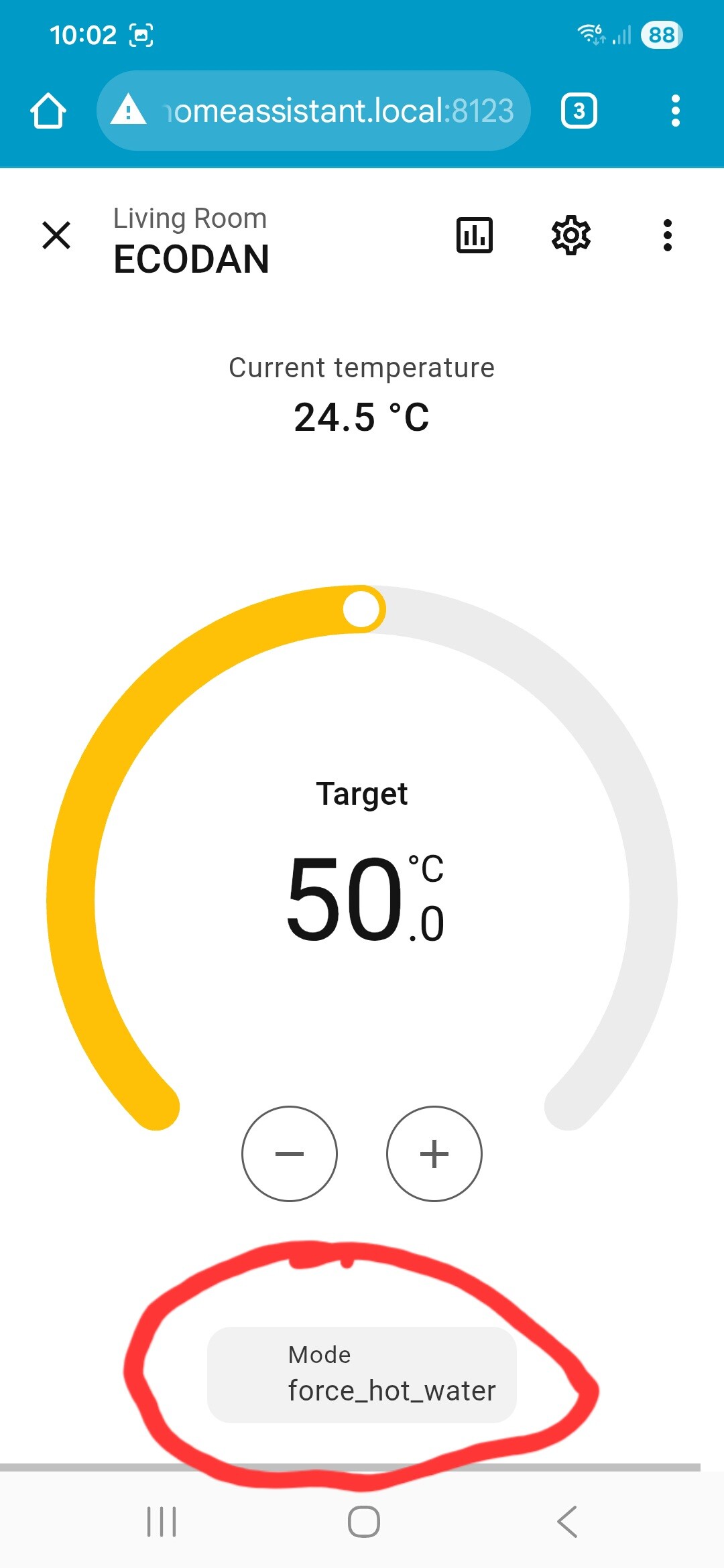

Again @IgorZg many thanks for your reply. I feel like I’m way out of my comfort zone on this. I’ve gone into Developer Tools and if i click on the Water Heater I get this:
Processing: 1000031381.jpg…
Are you saying that if I set up the Automation within Developer Tools should be able to access the Auto/Force Hot Water button?
I don’t know what exact actions are possible with your device, but yes, you can test it via Developer Toolss → Actions.
