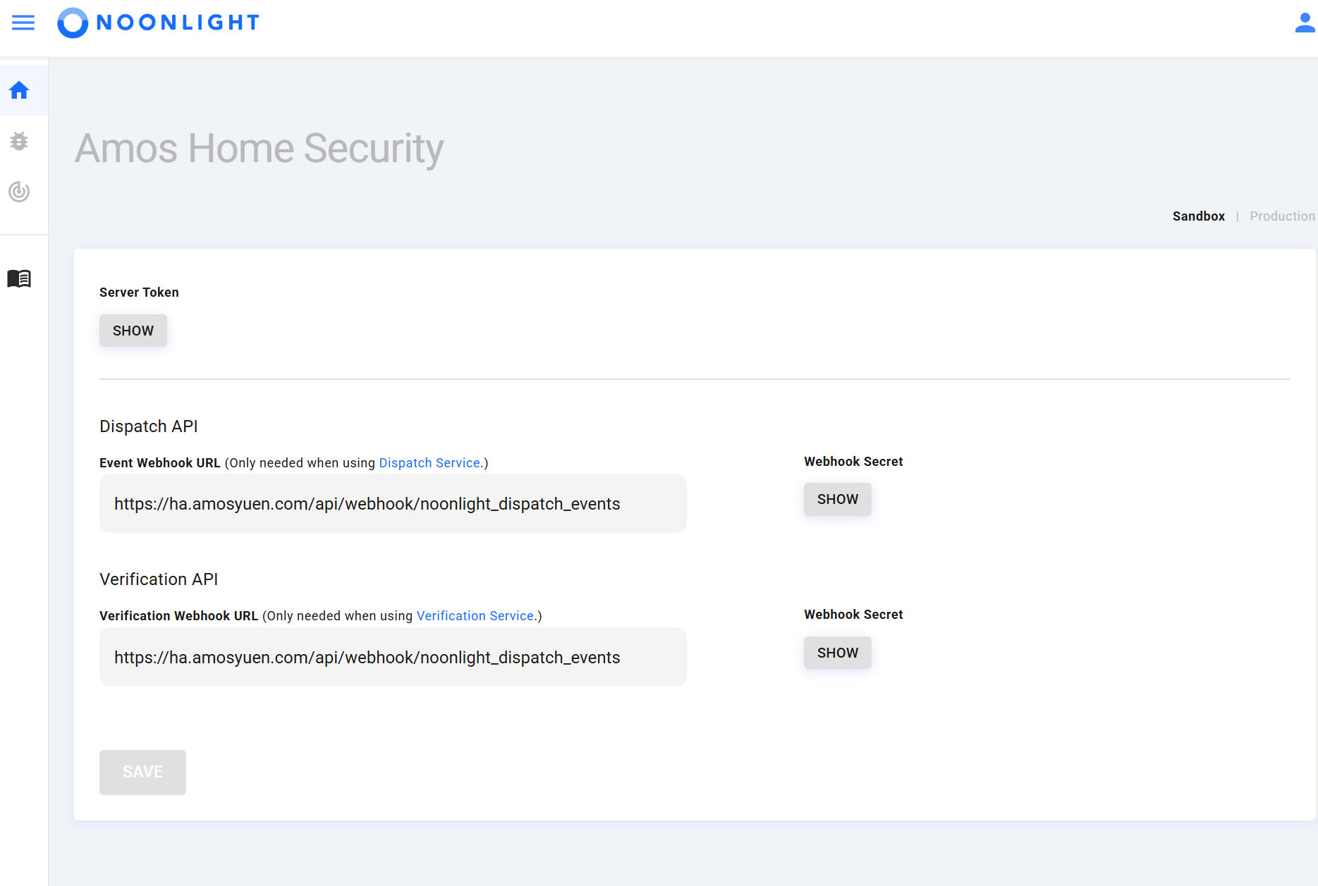

When setting up the integration it asks for client ID and client secret. Where do we get these fields? After creating a developer account on noonlight they only give me a server token field and webhook secret fields. Are those the client ID and secrets?
The current integration was originally built around Noonlight's OAuth-based workflow and expects a Client ID and Client Secret during configuration.
If you're only seeing a Server Token and Webhook Secret in the Noonlight developer portal, you're likely looking at the newer Dispatch API v2 credentials rather than the older OAuth application credentials.
In Noonlight's newer developer workflow:
  • Server Token = used for authenticated server-to-server dispatch requests
  • Webhook Secret = used to validate inbound webhook payloads
  • Neither of those is the same thing as a Client ID or Client Secret
The current version of the integration still has some legacy configuration fields from the original integration, although Noonlight Enhanced adds support for server token override workflows when using the newer API patterns.
