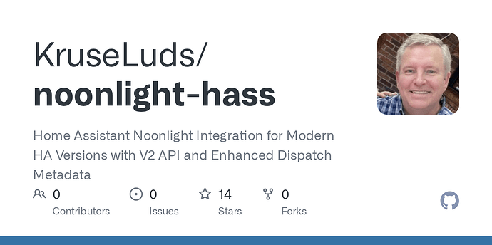

Great minds think alike! I totally hear you about the inconsistencies, sorry I was also on a learning curve early on with Noonlight so I may have made mistatements back then. However I have tested this thing to death so to speak so I have just added a clarification to the readme and now feel confident enough to formally make this release #1.0.0 so you should see an update available shortly from github in HA - please note specifically this section of the readme:
Thanks for your support!
Btw, I don’t see “Issues” tab in the repository. That would be great to enable that so people can report any issues found.
