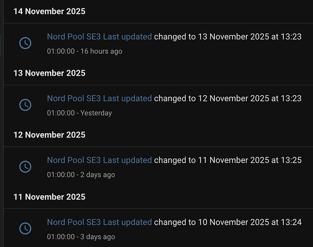

The nordpool integration “Last update” diagnostic sensor seems to be updating at 01:00 at night, in a strange way. Last night, at 01:00 on November 14, it suddenly changed from 12 november 13:23 to 13 november 13:23.
I expect it to change to 13 november 13:23 at that time (13:23), and not nearly 12 hours later. Seems like this happens every night.

Additional info, 01:00 in my time zone is 00:00 utc. (Updating the title.)

“Last updated” is a diagnostic sensor from the integration.
