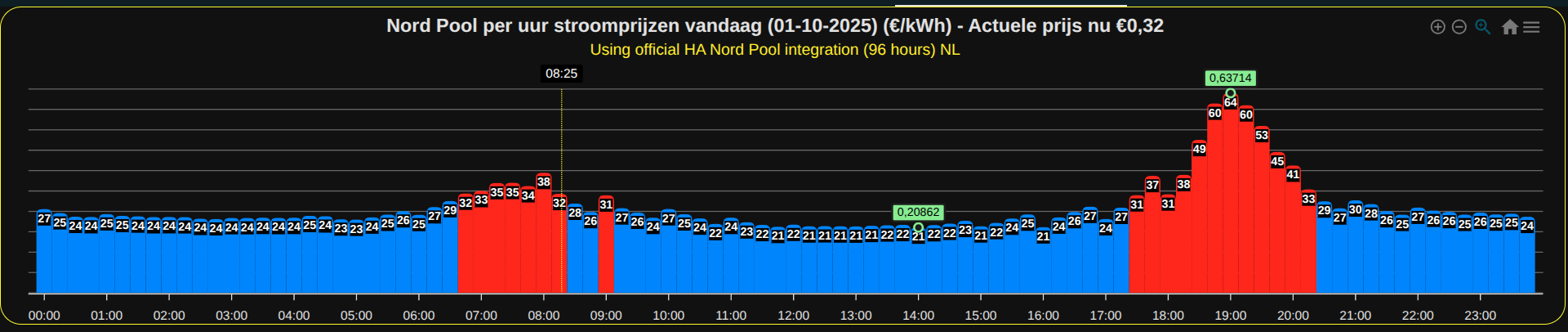

It’s the 30th September, so it was time to test Tomorrows data which has moved from 24 hourly elements to 15 minute elements (96 in total).
The top right hand Tool Bar helps viewing this amount of data.
And now it’s the 1st of October. Small change in graph values is due to my provider reducing the Purchase charge from €0.04840 to €0.02 at midnight.
this is with the core integration of Nordpool?
In that case: can you share the code for it please? I can’t find it anywhere…
